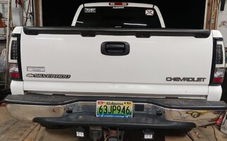

Added a pair of load resistors to the LED brake lights as the BCM was not happy and withholding cruise control. Funny that my 02 didn't do that with this same set of taillights. Must be a new feature they added to later years. One wasn't enough, I had to put two resistors. Next will be to figure out why the cruise light doesn't work. Never has since I've had it. It is an LS so maybe it was added post factory. Maybe just needs a BCM or IPC reprogram.

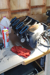

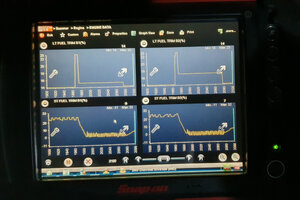

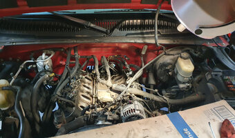

P0171 & P0172 on the Silverado. Time for Intake Gaskets. :worried:
(Graphs show idle, then revved up and held at 2k, yikes).
Quite a lot of connectors and stuff to get out of the way to get that sum-b out.
Out with the old, in with the new. No CEL anymore! Only took 4.5 hours including a trip to Advance to buy a fuel line quick disconnect tool after experimenting with picks and a sleeve made out of a beer can, cleaning the mating surfaces, dropping an injector lock clip UNDER the intake after I already bolted it down, and using only hand tools while standing on a chair.
