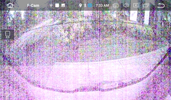

Making problems worse... I have 2 backup cameras on the EXT. The original one I put in the trailer hitch, and a second one at the top of the lift gate glass, on the interior trim panel. For a while they worked great, then the picture for the lower one stopped working. I didn't use it much anymore, plus the low resolution looked like crap on the 10" screen, figured the camera was dead (I had replaced it once before, and it was cheap) Then months later, the newer one started to flicker, and only seemed to work when the mornings were much cooler :mad:
Got my video adapter for my laptop, plugged in both cameras to it, and got a steady clear picture. Great so something is up with the radio, time to tear into the radio stack again...
Checked the connections at the radio, everything was good. Swapped plugs around a bit, tested some more, no improvement, so I gave up. Poked around in the settings to turn off the auto on feature for the camera when shifting into reverse, and looked at a few other things. The touch screen was always just a bit off, you had to tap about a half inch below what you actually wanted to select, so I re-calibrated the display. There were a couple other similarly worded resets, and I ended up resetting the button panel (physical buttons) on the radio face. :confused:
No big deal right? Can still get to everything from the touch screen, so get to the screen to relearn the buttons. Display says to press one of the buttons (same as for steering wheel programming), and then you press the desired function. But the problem is, the radio isn't recognizing when I touch those buttons, so I CAN'T program them! :hissyfit: Nothing in the manual about getting around this issue, so gonna have to find their tech support email, and see if I can get any help there. Not holding my breath.
Had a brain fart last night, later on, decided to Google my issue. And of course there were videos posted of fixing non responsive button controls :duh: It was part of the screen calibration process, after getting the touch screen set, press one of the buttons, and it would ask you to select the function you wanted. Like the steering wheel controls, you had the option for both long and short presses, which was cool. So got that fixed this morning before heading to work.
No dice on the camera issue. Lower camera gave no picture, upper one gave a fuzzy picture before heading out, and a flickering one once I got to work. Has me thinking some internal connection in the HU that separates as it gets warm. :frown:

Last night, tore my dash apart again, to mess with my radio, troubleshooting why my RCA cameras aren't working. Had previously disconnected the cameras at the rear of the truck, plugged them into my laptop and got a good picture. So assumed the HU was at fault.
This time, pulled the connections from the HU, into the laptop... "No input signal" :mad: What are the chances I have 2 separate RCA cables, that happen to be running up opposite sides of the truck, both being damaged and causing signal loss? Couldn't immediately find any RCA cables that long, in my rat's nest box of discarded cords and cables, will have to do some more digging. Pretty sure I used all of my long ones for the 5 channel amp. Something tells me, this black Friday could be an expensive one for the EXT 💸
You could run a resistance check on them as well as a set of good ones and see if there's a loss.

Got up this morning to do some tinkering. Disconnected both of the camera cables to ohm them out. The line on the newer camera tested open, the one on the older camera gave readings all over the place. :undecided: Found a long single RCA cable in my box, and tossed it in with the old camera, got a pretty good image on the head unit considering it's not an HD camera. Pulled the lift gate glass trim and fished out the newer camera connector, fed that directly into my laptop, flickering picture. :mad: Pulled that out, and fired off an email to the seller (they say they have a 24 month replacement guarantee) So we'll see how that shakes out.
Decided to test it again in the house, and was almost baffled, cuz the camera gave a crystal clear picture for about 30 seconds, and then started doing this again :hopeless:
