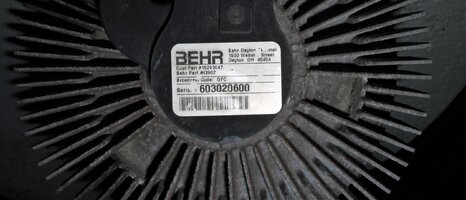

Also put some WD40 to the fan clutch. When spun by hand, It grabbed in spots and made a little noise. The WD40 seems to have solved the problem. I think a little rust was taking hold.

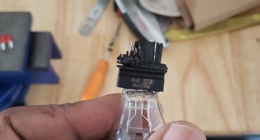

Last night, my buddy told me that only my 3rd brake light was working, and only the passenger side parking light was on. So this morning, had to do some troubleshooting :undecided: Everything was fine during the week, as I can see the front wall of my garage light up when I come and go.
First thing, checked the fuse... Blown as expected :rolleyes:
Unplugged the driver's side assembly, popped in a new fuse, and tested the circuit. Passenger side lights up, fuse stays intact. Pull the bulbs out, and check the problem child to find this :eek: Umm yeah, I think we found the problem... Or did we?
Turned my attention to the socket, and it was kinda nasty in there. Melted plastic from the bulb base, and half of one of the pins stuck in place. I'm assuming that the water that was coming in through the top of the bulb opening, was trickling into the socket, causing corrosion, which got things warm enough to melt the plastic, to the point one of the pins broke off and shorted the brake light circuit.
Used a pick tool to clean out as much melted plastic and crap as I could, plugged in the board with the socket empty and tested it. No blown fuse, so at least now there's no more short. Don't have any spare bulbs, so popped in the reverse light bulb for the time being. Will head out in a few for a fresh set. Probably order a new circuit board this afternoon just so I won't have to worry about it later.
