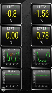

Gave my O2 a stink eye. Not sure if it is the cause or simply just reacting to what the engine is doing when it is doing its minor idle bog n surge.

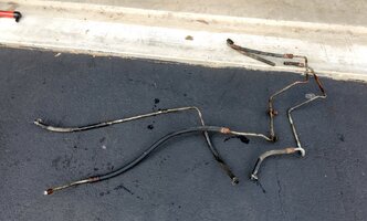

It took 7 hours, 6 beers, and, well, I lost track of my profanity, but the power steering lines are replaced! This was not nearly as bad as the trans lines in terms of the line fitment and connectors, the lines actually went in/out easy, but the location of some of the bolts was just ridiculous. Seriously, a bolt right under the crank pulley?! :Banghead:
Anyway, I did the bare minimum disassembly. I just removed the washer fluid reservoir, driver's side wheel, and upper control arm.
90651
It took the first 3 hours to get the old lines out. That time was mostly figuring out how to get my hands/tools in the locations to best reach the bolts and fighting said bolts while contorting on the floor and cutting my hands up.
90652
New lines in, everything (mostly) tightened back up, fluid topped off and 30 mile test drive later - the floor of the garage is dry as a bone after sitting overnight!
90654
Job done. :woohoo:

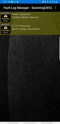

While out on the road weeks back I got caught in a real storm coming down from Rochester and through the Poconos. Damn thing followed me as I tried to outdrive it South. We all have storm stories, this was one of those where you can't see the lane markings. Used the guardrail to insure I didn't wander. 120 or so miles took over 3 hours. Wind blowing the few tractor trailers still rolling all over, the drivers who like me kept on pushing.
After I finally got out from under by driving enough Eastward, the 4.2 started to miss. #5, which is in a perfect line of fire from the front right tire when it is in deep water. The dirt on the top of the 6 shows exactly where the water was splashing up. It got worse and worse as I continued the last 240 miles, failing completely for the last 20 or so.
It's a 2004 that I purchased that had not had a good life before me. I figured if I am going to cure that miss I might as well do plugs. Rock Auto had Iridiums with a rebate so I bought a set. Also picked up coils at the same time.
Glad I did. Found gaskets on 2 of the other coils had failed and I would have lost them sooner rather than later. Can't expect them to last forever. That #5? The water was halfway up the pocket. Lotsa rags and paper towels to dry up the Roman Bath in there.
Replaced the air filter since I had that apart. Oil and filter changed. Next will be a rub and scrub of the throttle body, once I find a store with cleaner. Two were out.
