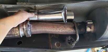

Had some fun Wednesday and went to install my cutout at my parents garage but ran into a snag and will have to take it somewhere for them to weld it up for me. I dont have a welder and I'm not comfortable with having to remove the hanger. I did get to change my oil at least lol20190724_175920.jpg20190724_191022.jpg20190724_175429(0).jpg
