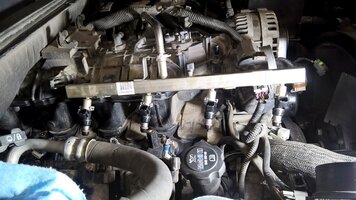

A couple of months ago I found a set of 8 NEW injectors for my 5.3i 9-7x for $49.95, but I had my wife's 99 Buick Park Avenue in the garage and now that it is done and sold.. it was time to do the injectors. I did find one of the old injectors on the passenger side that was bad reading infinite on the 20 ohm range. The other 7 were reading right around 12.6 ohms. I kept getting misfire codes indicating one of the injectors was sticking open. So now, the new injectors are in. All 8 of the new injectors measured 10.6 ohms. We'll see how it goes. I also installed new retaining clips.

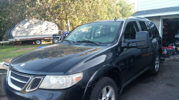

Popped the door panels off, removed the side mirrors, and put the stock mirrors back in temporarily. Maybe 6 or 7 years ago, the turn signal lenses got knocked off in a roll through car wash and the plastic posts on the underside of the mirror where the lenses screw in, were snapped off at the base.
90465
90467
As a result I used some 3M double sided foam tape which held up for a pretty long time, but is starting to let go a touch, and the lenses are separating slightly. I can squeeze them back in place, and they'l hold for about a day, then I can notice them sagging again. The other day, the passenger side had to be hanging about a half inch down. :eek:
90466
So off these come, so they don't let loose while I'm driving. Gonna disassemble the top sections, get some epoxy putty and pack it into that cavity where the mounting posts used to be. Clip the lenses back in place, so I can mark the screw hole, and then put a pilot hole for the screw to secure them properly.
