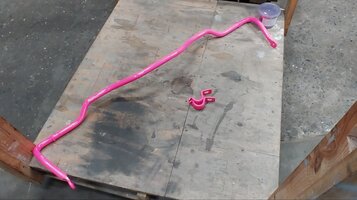

Since I had the extra rear sway bar for my rear diff swap and wifey wants to go with a different color scheme for the under side of the truck we went pink for tink.20181005_214013.jpgThis is the pink dedicated to breast cancer awareness and now the Envoy. I have a spare set of front and rear calipers & brackets that will also get coated.

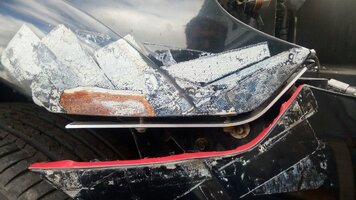

Today I found out that the driver side rear wheel well is pretty well shot. I knocked on the inner metal panel of the arch to see how solid it still is and, well... it has a big hole now instead. Oops. Nothing visible from the outside yet aside from the ugly rust bubbles on the bedside, but, yeah, that inner panel is gone. Passenger side is still solid-ish yet, though obviously rusting. And of course the rockers are going. But what 11 year old pickup truck driven in Ohio winters doesn't have rust on the bedsides and rockers? The frame is still rock solid and so is the power train.

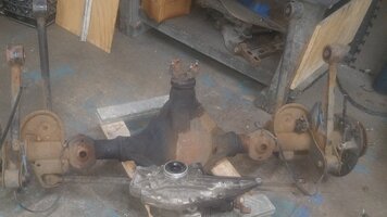

In its place I put all the stuff I have from the 4.10 rear end that's hanging around in my brothers shop ready for me to swap in.20181012_182041.jpg
