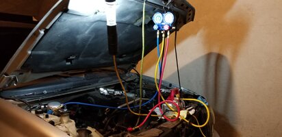

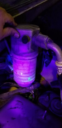

Found the major AC leak, been about 3 weeks with no AC... I live in bipolar Southern California, one day in the 60s the next in the 90s.... last weekend, filled it with 2 cans of 12oz Freon and a can of EZChill w/ UV Dye...AC last about 10 minutes, Looked like crazy with UV flashlight, bought a second flashlight not trusting the first one, lol... looked at the condenser thinking it was for sure the culprit, as I couldn't find anything.... Jacked up car looked underneath as I have the EXT model, nothing... finally since I had the front torn apart I told myself, well I won't lose anything and kept going, took off the air filter box, washer reservoir, coolant overflow and nothing.... out of nowhere, thought came in to my head, remove the sleeve... Jackpot... about 3 hours of diagnosing to find the leak... A visit to Napa and $60 dollars later, pulled vacuum for 25min and shut it off, checked vacuum 20 minutes later and it held... leak has been fixed, pulled vacuum for another 10 minutes... only thing left is charging the system... didn't charge it as I don't know how much pag 46 to add... I had to buy the gauges and the vacuum. flashlights, spent about $280-$300 including the freon... to my surprise not one drop of blood on this project... :2thumbsup:
View attachment 86478View attachment 86479
Screenshot_20181029-223214_Amazon Shopping.jpgScreenshot_20181029-223214_Amazon Shopping.jpg
This is the Freon I went with, 4 cans and 2oz pag 46 w/uv dye... AC gets down to 40 degrees rapidly, then begins cycling....
