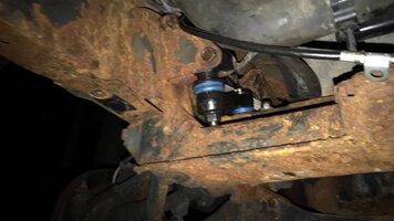

Tightened up the front passenger SMAXX endlink...she was a bit loose and after talking to SMAXX they said that would be cool as they know they can loosen a bit despite supposedly being torqued correctly out of the box.
