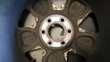

After cleaning the back of my winter wheels and coating the mating surface of the wheel and coating the hub again.... After 7 months of winter weather and corrosive road crap... there was no aluminum to steel interaction.. I guess for me, the CorrosionX worked just as planned.

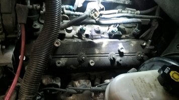

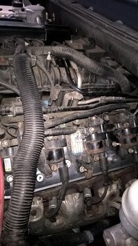

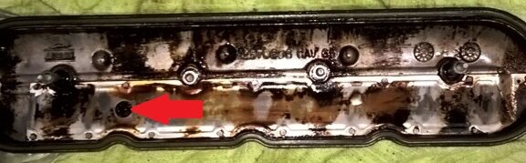

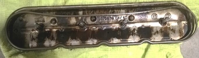

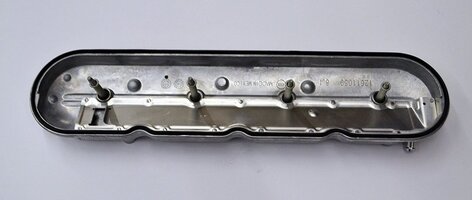

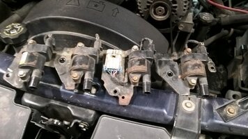

There's already a lot of pictures.. but here are a few more.. I put on my New Improved Style driver's side Valve/rocker cover. Didn't take too long other than my wife wanting me to carry stuff into the house from her craft room in back of the garage (that was suppose to be my work shop)
I took the vacuum brake booster line to give me more room to move the rocker cover. 106 in lbs for the rocker cover bolts. I also made sure the line from the "PCV" to the intake manifold was perfectly clean.. Test drove 27 miles to the nearest Starbucks to get an iced white chocolate Moca... No oil leaks... next job.. both front wheel bearings.. parts should be here next Wednesday...

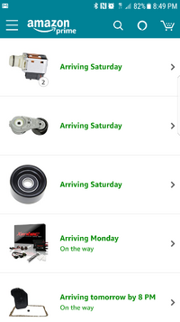

In the meantime, I went out at lunch to check my belt drive as I have some pulley noise. Idler is fine, tensioner arm is tight, but the pulley bearing is dry. The AC tensioner arm and pulley are both shot, dry bearings and non-linear arm movement. The dealer had put a new serpentine belt on when I bought the truck 3 years ago (and 62k miles ago), and it really is not in bad shape. The AC belt is bad though - grooves worn in the backside of it, and cracking.
So far in my shopping cart I have a new CV axle for the driver side, a set of front axle seals, a serpentine belt, AC belt, main drive tensioner pulley, and AC drive tensioner assembly. Contemplating putting an oil pan gasket and oil pickup tube O ring in there, since I think my O ring is seeping some (lower oil PSI than previous when stuff is cold, but gets better as it warms up), and since I'll have the front diff crossover tube removed to fix its axle seal most of the work to get the oil pan out will be done anyway.
Poor truck is just getting a bit old and some parts are wearing. I guess 190k will do that.
Ordered it some need to get done soon maintenance stuff.Screenshot_20180503-204918.png

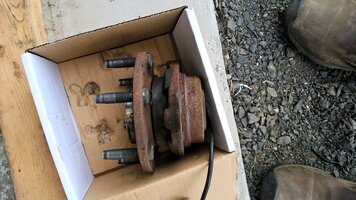

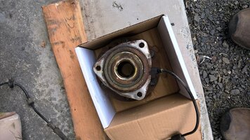

Changed my left front hub bearing assembly .. pictures of the old one.. cleaned... wire brush and emery cloth where the bearing is mounted (see all the rust on the bearing. The new one was treated with CorrosionX on all mating surfaces (this time maybe the mating won't procreate rust!) I'd forgotten that the passenger side did NOT have a brake backing plate when I put on the new drilled rotors. So, I just ordered a backing plate for the right side. At least I know that the right side has been changed at one time. So either Saturday or Monday I'll be doing the Right side once it arrives. eBay prices were not even close to Rock Auto even though I paid priority shipping.. The old abs sensor mounts.. well one of them was a PITA... to get out. Gee I wonder why the Left side was running hot when I tested it with my thermal gun...

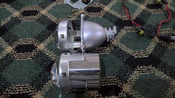

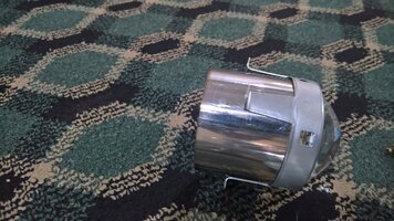

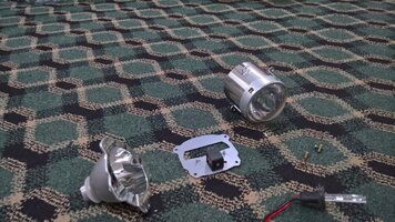

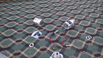

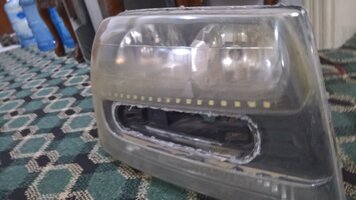

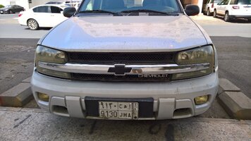

Finally got back home yesterday and already am into my TB. Sadly had to remove the projectors due to out Motor Vehicle Periodic Inspection (MVPI) cause the guy couldn't figure out what the hell were projectors doing in regular housings. However I'm taking it as a positive and hope to get my custom shroud on them and as soon as the MVPI is finished will be putting my projectors back in and angle them and seal it up for good 😉
WP_20180509_09_38_19_Pro.jpgWP_20180509_09_16_04_Pro.jpgWP_20180509_09_15_53_Pro.jpgWP_20180509_09_12_21_Pro.jpgWP_20180509_09_12_15_Pro.jpgWP_20180509_09_02_09_Pro.jpgWP_20180509_08_59_44_Pro.jpgWP_20180509_08_59_40_Pro.jpg
Passenger side wheel bearing. Had intermittent ABS light for a few weeks but it started to groan a little today so swapped it out after work.

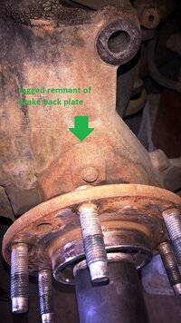

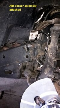

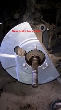

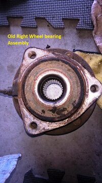

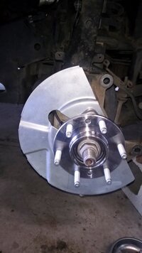

Brake back plate got here today so I did the Passenger side Wheel Bearing assembly of my 9-7x. What was very interesting from the removal and install of the wheel bearing assembly was that the 3 bolts holding the the assembly, which are suppose to be tightened to 77ft/lbs.. I was able to break them loose with a 6" fine tooth ratchet, with very little effort. Now back in my younger years I'd been known to break loose the 4 bolt mains of a 375 hp 396 in the Air Force Hobby Shop at Elemendorf AFB in Anchorage, AK.... I'm sure I couldn't do that now at 71... but I do KNOW how hard it is to actually torque those 3 bolts to 77 ft/lb with a shorter than normal digital torque wrench... but those bolt today were pathetically tightened.
I actually, got out my wire brush on my drill to clean all surfaces and treat with CorrosionX before assembling. I'm not sure how anyone can expect the install to go correctly if the mating surfaces are not rust free. But each to their own... Thanks again, goes to Rockauto for the great price on the Brake Backing Plate! It seems this bearing had actually been changed once before... at least now both of mine have been installed within a week of each other so I am personally aware of their status.. next .. rear shocks as I know I popped them when I was towing my Lincoln Continental from PA back to Eastern Washington on an overly heavy Uhaul car hauler.. I actually heard the pops but it was NOT the air bags..

Torque wrench? I've never used it on that. I just use the German measurement gudentite. And we usually don't bother replacing that shield and just rip it off. Quite useless.
