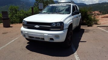

I'm iffy about those, but now you can do HIDs without being one of those jerks HIDs in halogen reflector housings.
I did not think those were projectors? Not a real halo fan myself, but they are better than some of the ones out there for sure.
I figured out my rattle since the last wheeling trip. No more exhaust heat shield by the muffler now. With the body lift I do not think it was really needed anyway.
They have projectors in the low beams. Not sure if H1 or H3, I think H1.
Which lights are those? I have a set of chrome dual halo lights in the garage, but they are not projectors
