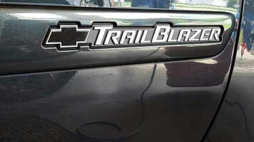

This was yesterday...after I seen @$ Khalid ! 9130 post the other day, it had me wanting to do some modern black-out of the Chevy Bowtie emblems on my TB...
So I ordered some Gloss Black Vinyl and got out the X-Acto Knife...
Wanted to see how it would look on my TB...I like :yes:. So now I will be ordering more Vinyl to black-out the Bowtie on the front Grill.

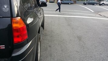

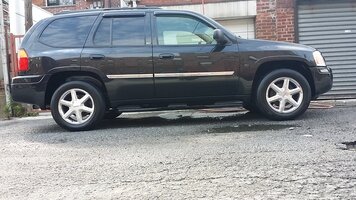

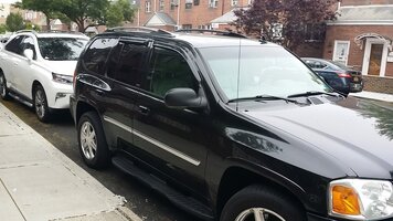

Ummm where do I start.... well I hot the whel spacers on first thing in the morning . I didn't do it myself but took it to the guys I trust.20160527_070822.jpg 20160527_070807.jpg 20160527_072311.jpg
The first is before 2nd is and last is after.

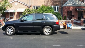

Then lastly is loading her up to head out.

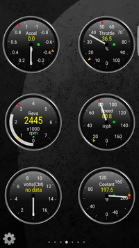

Ok, i was just curious cause I just did a Coolant Flush and replaced the T-Stat, CTS and Radiator Cap and wanted to be sure i got the Coolant mixture right or close.
I maybe a little strong on the Dex-cool side...
Above is after 5 min of 70-80mph...
And above is at Idle for 5-10 min...
So it looks like I am very close on my Coolant Mix. I think I have a little more Dex-cool than Water but not enough to worry.
Thanks everyone!
