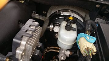

Replaced the vacuum brake booster check valve added a clamp as my hose Seems a little too loose when going in. I might need to get a new replacement hose for that but the clamp tightened thing up a bit.20160709_092126.jpg

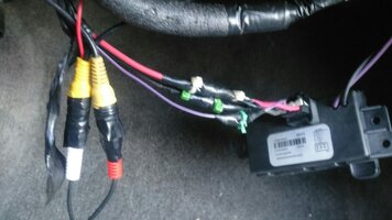

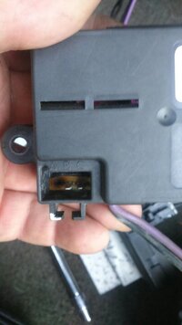

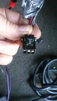

The blower in the TB quit working. The connector to the blower module heated and melted the pin of of the module. Connector was also melted. Lucky me I have a whole parts truck. Cut the connector from the donor truck, which was mint, and did the triple bypass surgery. All good now :biggrin:
