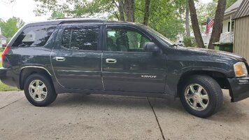

I have spent the last 48 Hours getting this thing in clean and pristine shape. Now that I got help from another member here and all works it was time to get her feeling good about herself. Looks amazing. New Led lights inside, Headlights, Corner lights, Fog lights, Tail lights, and Reverse lights! Gonna try to restore the headlight bezel now!

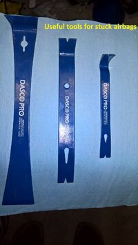

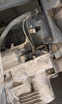

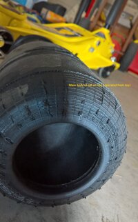

This was sort of a week long project.. It started out as both rear axle seal suddenly decided to leak.. mostly on the passenger side. I decided since I had some other new parts that I'd been putting off installing .. rear swaybar bushing endlinks and New Arnott air bags. I thought I'd do the easy part first... replacing the airbag as I'd done in before on my previous 05 Buick Rainier (Which had NEVER been in the rust belt!) I was not as easy in the Saab that had spent 8 years in the rustbelt before I purchased it. The bags were NOT easy.
Access2AirComp.jpgAirbagAirLines.jpgBottomLairbag.jpgCleanedPump.jpgCompressor01.jpgCompressor02.jpgNewAirbag.jpgNewArnottAB.jpgNewLeftAirbag.jpgOldAirbag1.jpgOldAirbag2.jpgOldLeftAirbag.jpgUpperAirBagProblem.jpgUsefulTool4RustBelt.jpg

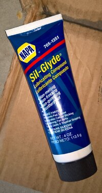

Now part 2 was the new rear swaybar bushings & new rear swaybar end links. I only had a problem with one nut on the top passenger side which I had to break the nut with a nut breaker as the allen hole that became round just as the nut was about off.
View attachment 100594View attachment 100595View attachment 100596View attachment 100597View attachment 100598View attachment 100599View attachment 100600View attachment 100601View attachment 100602View attachment 100603View attachment 100604View attachment 100605View attachment 100606View attachment 100607
FWIW, back in the day we used to run a vacuum line from the engine to the bags and then start the car. Collapsed the bag and it literally falls out.
