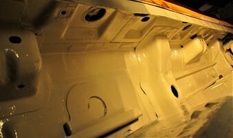

Cleaning up the back side of this rocker involved working with a needle scaller and then sand paper. Brushed on 3 coats of Rustoleum primer and 2 coats of high gloss almond. I'll brush on 1 more coat and call it good.
Lots of surface corrosion and flaking paint, but no serious rot. Caught this rust in time.

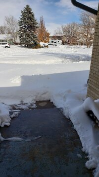

This happened yesterday, but got the Envoy stuck trying to leave our alley way. The city plowed and made a wall that was about knee deep. I goofed and let off the gas as I got half way through, took about an hour to get unstuck. :duh: Pretty sure the neighbors didn't appreciate the 7 AM wake up call lol. Only evidence left behind were the tiny specks of rubber. Though that little ordeal has been getting me to think about getting a lift kit :biggrin:

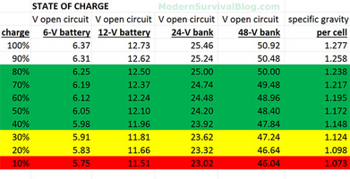

This chart below isn't the exact one I wanted, as I tend to go by the "50%" rule (e.g.; 11.99 volts is the most I like to let a conventional FLA battery discharge). But it's the first one that I found on my HDD, so here you go: :coffee:
(note: AGMs can discharge down to 30% SoC before they're harmed... and as I look at this chart, you'd think it was geared toward AGM, but it's supposed to be for FLA-type batts)
