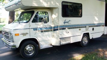

Did visits to my parents and friends in two separate counties along with a trip to a beach. The SUV facilitated my first in-person meeting with friends without masks on as we are all vaccinated...had been over a year. Other than a poor quality rear brake pad cracking and causing a super annoying warped rotor feel, we continue to roll along without issues. New gold rotors and pads from ACDelco go on next weekend, decided to splurge on the good stuff given I'm two weeks out from 150,000 miles.
Looks to be in very good shape considering the age!
Reactions: northcreek
Thanks !, Been garaged when not in use and never seen the winter so it has lived a charmed life. Got an engine transplant in 2017, that bastard Interstate 40 into Albuquerque killed the sbc and Reliable Chevrolet Inc. got a little richer.
400sb? Surprised you didnt opt for the 6.0LS upgrade.
