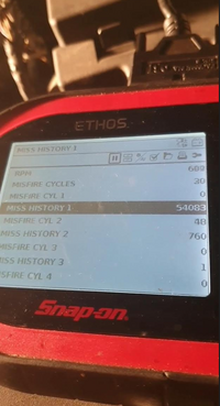

I tried driving the GMT360 to work... didn't quite make it before my 4.2 did the Colorado/DoD/AFM mod and decided to drop down to 5 cylinders to save fuel of course.
I did the right thing and limped it to work, worked all day, then drove it the whole 22 mile journey back home with a flashing CEL on 5 cyl.
Tore into it and swapped the coil pack from #1 into #2. Yup, bad coil.
I did the right thing and only replaced the bad coil. Drove it to work today running like a top.

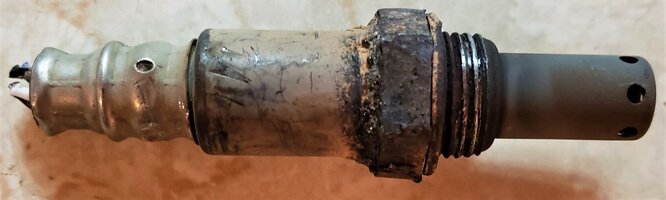

Forgot to check the codes but took a picture of my fuel trims. I have yet to really read and understand them yet.
I watched the output of the O2 sensor. At operating temp at idle it was dead around .64 to .68 volts. Lightly revving I could get it to get a bit north of .7 volts. I really ned to get that changed.
