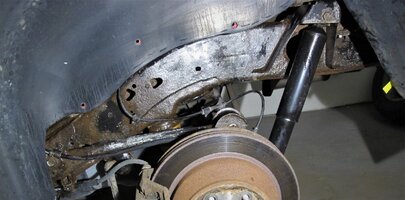

Can anyone explain how this plastic inner fender liner is removed? (Back driver's side.)(I pulled the clips and the screws but it's still in there pretty good.
Better to ask in its own thread. Not everybody reads this one.

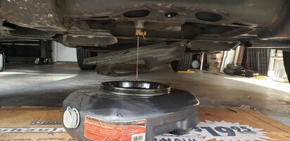

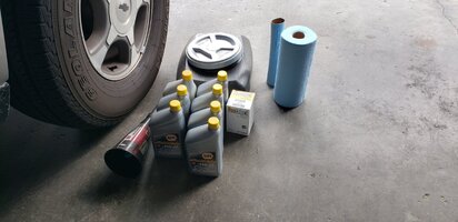

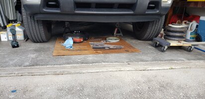

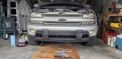

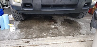

So I took these classically staged pics, cuz that's what the cool kids do these days... :pictures:
and then decided to take a couple more for good measure and authenticity's sake. BTW, I love my Fumoto quick valve, but damn you better not be in a hurry to get your fluids changed. :nono: :laugh:
Got the new filter on, minimal spillage on the cardboard, filled it up, and went for a quick start.... Immediately heard the sound of it puking out oil like it was trying to shotgun a keg. :eek: Shut it off, and run around to the front, seemed to be coming from the filter. I thought it was on pretty tight already. Have had a time or 2 where I developed a drip from the filter being loose, but this was like it wasn't even attached. Wiped up as much oil off the ground as I could (3 of my car towels are shot at this point) shop rags to wipe down the frame, reached up and tightened the filter as much as I could with what grip I could get. Got maybe a half a turn?
Needed to put 2 more quarts in (glad I bought a case, and had 1 leftover from the last time) Go back and start it again, same damn thing :mad: Not knowing what else to try, I took the new filter off, and put the old one back on. Hand tight like always, 2 more quarts go in, turn the key and no golden oil fall from the engine bay :confused: Got the expected dripping from the fan blowing air around. This was the aftermath, after sopping up the rest of it. The cardboard only got so much, before it got soaked through. The old bath towels kept it from spreading all over the garage.

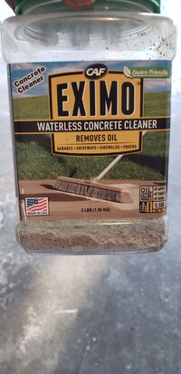

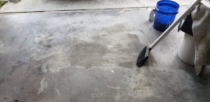

I had some of this waterless concrete cleaner on the shelf. Have used it for much smaller messes when I've dripped oil, tranny fluid or coolant. Nothing quite like this. So we'll see how well it works on a larger scale.
Put an old tarp out on the driveway to park the EXT over, to catch anything else that dripped, pulled the truck out, and applied the cleaner to the garage floor. One of the things I like most about the powder is it sticks to the wet areas right away. The worse areas darken up quicker as it absorbs, so it's easy to know where to re-apply, or sweep some of the excess back over. I sprayed some diluted simple green on the tires where I rolled through some of the oil, as well as on the frame and undercarriage where I could reach. Hoping to get as much to drip off onto the tarp as I can, before putting it back into the garage.
I had that happen to me a long time ago on my wife's (then girlfriend) 89 Civic. It was a Fram (didn't know any better then). The threads in the filter were defective and wouldn't screw all the way in. Made a helluva mess.
Who makes that Proselect filter?
It was the Napa house brand, it was on sale at the time, so figured it would be fine. Lesson learned, stick with what I know. It didn't feel right on the first few turns, abnormally tight, but then it loosened up some and seemed to go on like normal. Wish I would have stuck my phone in somewhere and took a pic to see what it looked like, but as quickly as the oil spewed out, there had to be a large gap where it should have sealed.
I thought Napa's filters were made by Wix. They're usually good quality. I couldn't find a recent video about the Proselect cut open so can't confirm.
I guess you'll get it exchanged or refunded?
What almost happened to me, some scumbag switched filters/boxes at Wally World. And I would have put a low pressure filter on the Nox instead of the HP filter that it needs. That means that it would have blown oil through the bypass valve instead of the filter media.
So that lowlife thought that wrecking someone's engine was worth it if he saved two bucks. :no:
( The older PF63 has a by-pass pressure of 12 PSI. The newer ecore PF63E has a bypass pressure of 22 PSI. If your application calls for the 63E and runs at a higher oil pressure, it's possible the classic 63 might run with the bypass open, allowing unfiltered oil through. ... the pf63 is disc.)
