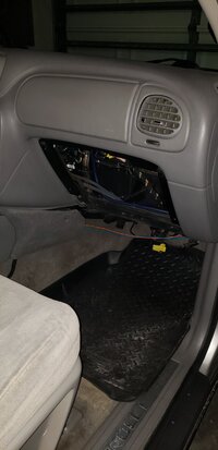

Took apart the dash for some HVAC troubleshooting. Thread coming... Yes, another one...
