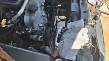

20240607_115257.jpg20240607_115300.jpgPulled off the alternator just to degrease and pressure wash all types of dirt off the front of the block.20240607_115311.jpgGot the last 2 parts delivered while I was still flushing all the old coolant out. 20240607_115624.jpg
It's was all back together and no leaks by mid afternoon but now my ac has a slight whine.😡 Which was probably already there I just couldn't hear it over the sound of the water pump.

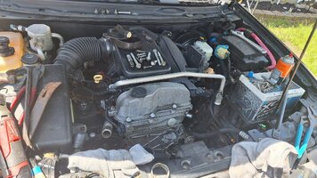

The TB started leaking power steering fluid AGAIN do decided to tackle this yesterday since my son will be using it to tow his newly acquired pop-up camper this weekend. Start by tightening the hose connections on the return lines and cleaned everything with brake cleaner. Still a drip but saw that it was the Dorman cooler that was dripping from the bottom line :mad: . Take the cooler out (I have developed a method of removing/installing it without taking the bumper off) and plugged the lines with plastic squeeze bottle caps. The aluminum line goes through the cooler's steel bracket and rubbed a hole in it. Cut the line before the hole and put some rubber tranny cooler line with worm gear hose clamps. Put everything back together, fill it, start it and POW, a line blows off the metal line. WTF? It was one of the metal crimp clamps. Replace the crimp with a couple of worm clamps, the other end behind the shock tower with a crimp clamp blows with a geyser, fix that one and I bypass the cooler in case something went in it or something. That last line blows again.
By then, my wife is home and she picked up some wings for dinner. Scarf them and down a beer. Go back out and start to think. I then see one of the caps I used to plug the hoses on the ground. Mother:lipsrsealed:! I left one of the caps in the line and pushed it in with the hard line. Cut the line back to the cap, reconnect everything, refill and it's good. Was then left to clean up the mess :frown:.
Since I had removed the fan and clutch to get to one of the lines, I thought I'd try out an EV clutch I had hanging around the garage. Hook up the Tech 2 and command it to 100%, nada. Put the thermal clutch back in. Then checked the A/C, not cooling much and clutch cycling. Hook up the gauges and yep, very low. Refill it and she's good and chill. First time I've had to add refrigerant. If it leaks out again, I'll sniff it out.
