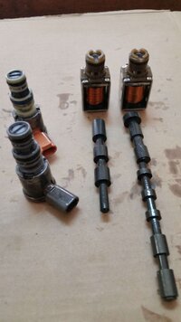

Swapped out the shift & TCC solenoids in the transmission. The pan looked good; some magnetic gunk on the magnet but not a lot. Was able to extract the 1-2 & 2-3 shift valves and they were clean and moved easily in their bores. Have to say, working in this heat is a challenge. Got off to a late start yesterday doing all the prep work (drop the exhaust, ready the pan for removal), by the time I called it quits it was already 106F outside. Started off much earlier today, by the time I had the solenoids installed and the pan back in place and torqued it was already 107F (on the way to 114F) so I called it quits again and then flopped into the pool. Whew! Will finish tomorrow.

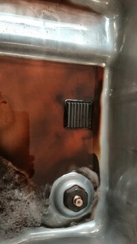

Spent this morning pulling the intake manifold to change out the gaskets, the hissing sound I was getting near #5 and #7 started to get louder with the temp changes the last week or so. Also was tired of the cold start misfire/rough idle that would go after away after 30 seconds. Each gasket had a flat spot that was allowing a vacuum leak on each cylinder. Got it back together, and it's much quieter and the cold start idle surging is gone too it seems like. The real test will be when we dip back into the low 50`s tonight. Hoping to knock out the radiator once the TB is back, that'll be the last major thing and then from there it's just the diff service front and rear to worry about.
While cleaning up, something caught my eye. So the truck has AFM disabled via tune, however, the factory harness is capped off (looks original) where the connector would be that would plug into the VLOM for controlling the AFM Solenoids. The VLOM connector is loaded full of debris, which has me wondering if the 05 SWB models had AFM disabled from the factory while retaining the hardware. 🤔
