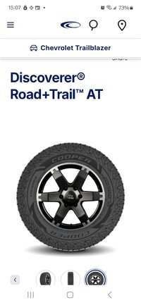

I knew they had updated the AT3 truck tires but on the Cooper site, they have changed it a bit more for the Trailblazer and renamed it. I'll see what the shop can get.

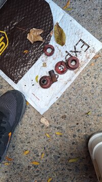

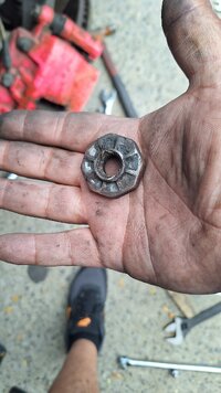

Cat back exhaust and these odd little bump stops. I had a garage replace my exhaust a few years ago in order to pass inspection, but they used an aluminized set. It rusted out. So got stainless this time. Couldn't quite arrange the resonator delete, so just went back to stock design.
Discovered that I'm missing a few hold downs for the heat shield, so it was riding on top of about 2/3 of the old muffler. I'll go get those later today.
Also discovered two of my stabilizer bar linkages are wobbly. Project for another day, since I think they'll have to soak for awhile unless I want to try to cut them off. But not gonna do that until I have the replacements in hand.
Those bump stops appear to have been original. Almost looked like they'd been burned! The new ones look too shiny/clean... ;)

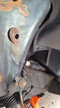

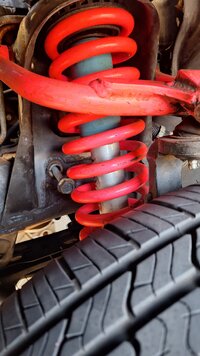

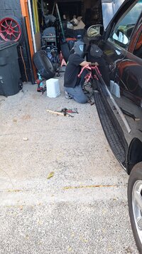

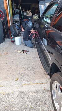

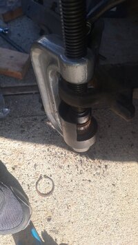

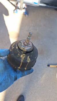

20241101_111909.jpg20241101_111913.jpg20241101_111921.jpg20241101_113421.jpg20241101_125741.jpgYeah, well that happened. Lucky for me my brother has a shop and he's hired someone who could weld it back in. Replaced the bushings, sleeves and bolts packed in some fresh grease and that corner is all good again. I'll be doin the other side at home tomorrow since I won't be needing to weld anything back in or at least I think I don't have to weld anything back in. 🤞

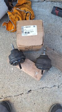

I've also ordered up some motor mounts and lower ball joints which I'll try to get to tomorrow if I have enough time/daylight.

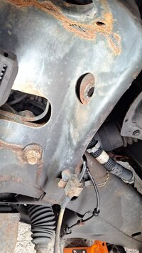

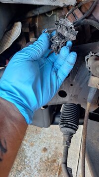

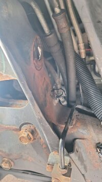

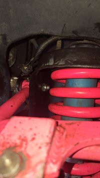

Found this before I even started working on it. ABS wire to the hub was siting on the exhaust manifold. No codes and wires seem okay, I'll let if fly till I order up that male and female connector 20241102_104243.jpg20241102_104248.jpg
As luck would have it 1of the welded nuts for passenger upper control arm is spinning so I'll have to get that welded in next friday. :duh:20241102_121100.jpg20241102_130535.jpg20241102_130526.jpg20241102_121129.jpg20241102_121046.jpg
Removed and installed Motor mounts. Wasn't to bad this times around. Last time I did them was I wanna say 8yrs ago and over 140k miles ago.
Lower ball joints and smurf blood refresh is gonna have to be done next weekend.

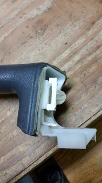

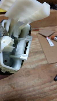

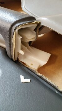

Fixed a broken retainer for the passenger side switch panel. Saw it was loose the other day and after a quick wiggle it was clear that either the clip on the switch panel or the corresponding retainer on the door panel interior was broken. Took the panel off and found that the retainer was broken, Looking around the garage for a piece of ABS (that I had been saving for just such an emergency!) I noticed the locking clasp on an old pool chlorine bucket bore a striking resemblance to the shape I would need to fit into the door handle. A little trimming & shaving and some epoxy; works like a charm.
