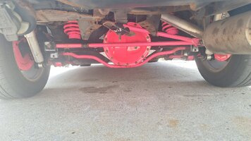

When I jacked the rear, I saw a huge puddle. After flushing the rear brakes, I checked and it's smurf blood! The transfer case is leaking at the front drive shaft seal. I'm pretty sure it's not the first time as I faintly remember replacing it early on when I first got the truck. It could have been initiated by my son using 4x4 when he went to the family land lot with his pop-up camper as it was a bit muddy there. By this time, it was too late to go looking for a seal and more smurf blood. I'll also have to check the diffs. The rear looks like it's leaking but it could be rustproofing oil.

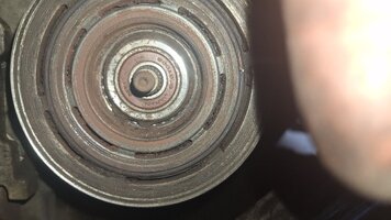

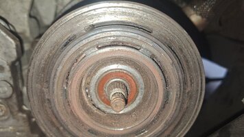

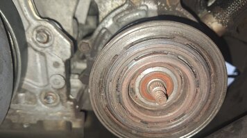

This past weekend I replaced the ac clutch. WTF? Those clips are the absolute worst to get out and in.20240628_184452.jpg20240628_185205.jpg20240628_200241.jpg
Just a heads up the new ac clutch shim/spacer did not work on the shaft (to small) of the compressor. I used the original but the clutch was slipping so I removed it and everything is working great now. Ac is the best it's been in a while. The bearing on the original clutch was completely toast.

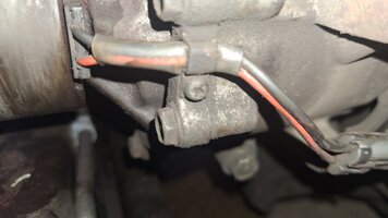

The transfer case seal swap was relatively painless however the old seal was all swelled up and turned to mush. I don't think I put seal conditioner in the transfer case but I didn't trust the fluid that was in there, which was still very blue, and replaced it with new AutoTrak II.
Both diffs were a little low but checking with a zip tie, the fluid didn't look that bad so I just topped them up.
Wow! You weren't kidding that thing was toast! I'm waiting on my clutch puller to arrive, I'm curious to see what mine looks like off the Trailblazers old compressor.
As far as the shim goes, was that from the Aliexpress kit? Or some other?

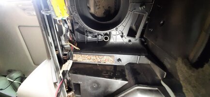

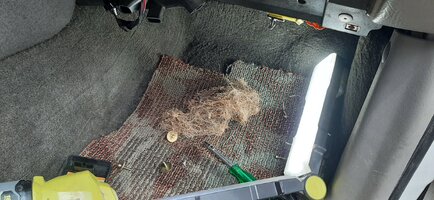

Pulled the blower out for a look. Someone had been busy in the outside air intake it seems!!
Since it is a 2002 I have the provision for a cabin air filter. Pulled off the door for that and found another load in there!
Examination of the material shows no signs automotive materials so that's good. I need to investigate and see where the access was.

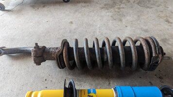

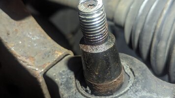

Managed to get the struts changed out on the Trailblazer last weekend. Rented a 3 piece pitman arm puller kit from Advanced, but they didn't fit over the yoke too well. It did pop free, took my foot as leverage against the fork and a few blows with the BFH on the stud. Finished up in about 4 hours. It wasn't terrible, but not a fun job either.
UCA (mainly the bushings), and UBJs are shot as well as the LBJs. I've got new LCAs with the BJs already, just waiting on tie rods to get here. Rides much better though, but still not great over bumps. I think the stock 18" low profile wheels are contributing to the rougher ride.

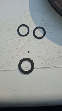

It was the kit from Aliexpress. I'll post a pick later when I get home of the difference.

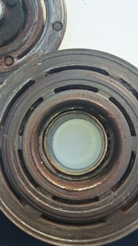

Pic's of the oem and Aliexpress ac clutch shims. Original at the bottom and 2 from Aliexpress on top. 20240728_080359.jpg20240728_080409.jpg
Looking at the old clutch again and everyone can see where the carnage all happened.

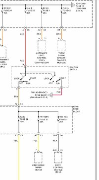

Had the weirdest issue with the Envoy the last few days. The front wipers stopped working, stayed parked no matter what speed the control was set to and it wasn't activating the washer fluid pump either. Did some digging around, and came across a post on the OS of someone having the same problem as me...
The fix? Replacing the ignition switch. Sitting here in the parking lot at work going no way, that couldn't be it. Swapped the old switch with the new Dorman I bought as a spare, and the wipers are working again. Swapped the old switch in, and back to not working. New one goes in and it's working.
Will report back how the Dorman turns out. I've got a WVE (NTK/NGK) switch as well that's my other spare, so we'll see how long it lasts.
Yep! Powered from terminal A (brown wire) of ignition switch. Contacts probably getting pitted.
Oh wow! I didn't realize how much the switch was actually tied into everything! What an odd decision, I guess it makes sense that its usually the first suspect in anything electrical gremlin related going on.
