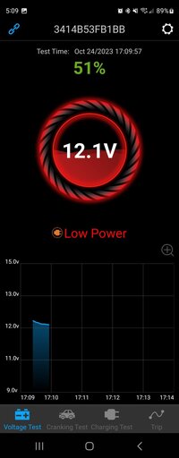

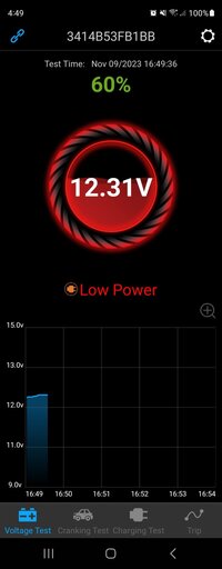

As mentioned in a previous post, I had noticed some battery issues after the EXT was parked for a few days. With a 4 year old battery, thought I may be due for a new one. Had gotten into the habit of throwing the charger on it overnight, when I new I had to go somewhere after being idle and that was working OK.
Here's a couple of screen grabs of the battery monitor when getting home after the evening commute, when I first noticed the problem, and after about a month of the 'Monday night' pre-charge routine. Somewhat of an improvement at holding a charge, but dropping this low after turning the key off was still a concern.
Screenshot_20231024_170957_Battery Monitor.jpgScreenshot_20231109_164936_Battery Monitor.jpg
So this weekend I decided to throw the charger on Sunday mid day, all day Monday, and pulled it off this morning as I needed to hit the grocery store for a few things. The graph looked the same as always before pulling the clamps off, but the voltage stayed at 12.8V instead of dropping to 12.5 immediately, and slowly going down to about 12.3. When I opened the driver's door and woke up some modules, it dipped to 12.5 but held steady.
After the short round trip to the store, checked it again, and got a steady 12.6. She'll be parked for the rest of the day, but I've got some pretty lengthy drives ahead of me Wednesday and Thursday, over an hour 1 way, so I'll really get to see how the battery looks after some heavy usage by the amp, and then be parked for the weekend.

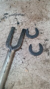

Tackled the ball joint replacement job over the last couple of days. Everything was going as expected until I got to separating the lower ball joint from the knuckle. I was using a pickle fork so I knew that there would be some heavy smacking required but this went way beyond what I was expecting. After multiple sessions (I had to walk away, lunch, etc.) I had to conclude that something was not right.
I was using a HF pickle fork that I had used previously (& successfully) on my CJ7. For some reason, it felt as if the fork was bottoming out. On a hunch I checked the fork (now all beat to hell) against the new lower and, to my surprise, found that the width of the ball stud was larger than the separation between the fork tines. So, went back to Autozone, and picked up a loaner fork with wider tines (I already had the ball joint press & accessory kits from them).
But . . . the wider fork also bottomed out, despite being wider than the ball stud!!!!
By now the grease boot was all gone so I checked the thickness of the fork tines and compared against the separation between the knuckle face and the control arm face. The problem was that the fork was not able to go in deep enough to fully engage the max thickness of the fork before bottoming out against the knuckle body.
I fabbed up a couple of spacers (1/4" total) to slip around the ball stud, slipped them in place, and after a dozen good shots the knuckle separated.
From there, pressing out the old joints and pressing in the new was straightforward. Rinse & repeat on the other side (albeit a lot quicker).

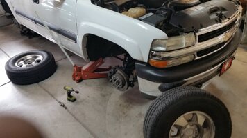

Got the winter wheels put onto the Trailblazer, gotta drop her back off because Discount Tire isn't balancing the wheels properly. Rear ones are still vibrating when going over 50.

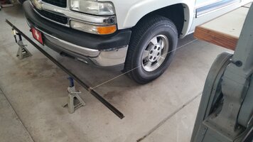

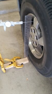

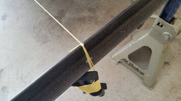

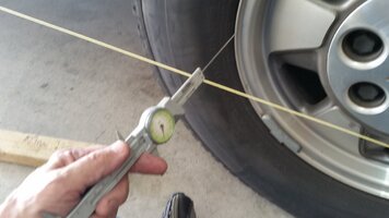

After replacing the ball joints and rotating the tires I checked the alignment (toe & camber). 20240114_131259.jpg
The front & back reference bars have identical pairs of notches that ensure the string is properly located. The jack stands are set to pass the string thru the center line of the wheels. For toe-in, I measure out from the fore & aft rim edges of the front & rear tires tire to the line.
Measurements are then entered into an Excel spreadsheet to get the results.
Camber calculation uses a similar technique.
Results: total toe-in was in spec (+0.1deg actual vs, +0.1deg to +0.2deg) whereas camber was slightly out of spec (+0.1deg,+0.2deg vs. +.25deg to +.50deg).
