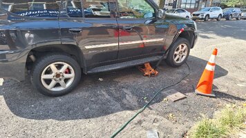

:dielaugh: Yeah, so about that.... Tire looked a lil pudgy this morning, and had lost a few pounds compared to the rest. It was still within specs for the EXT, since I run them a little high due to the larger size.
13mm socket would have spun it out, if the head wasn't so worn down, vise grips to the rescue. After a couple of turns, cold hear the hiss, and eventually this is what came out. I'm usually pretty perceptive and manage to avoid things in the road, but whatever was whipping around in the wheel well earlier in the week was definitely attached to this before it broke off.
HF was out of their plug kits, which kinda sucked since it was a bit of a drive. Paranoia had me thinking every little wiggle or shimmy was the tire losing more pressure. Stopped at the AZ right by the house and got one of their kits. After getting home, I found my old plug kit, but remember I broke the handle on the insertion tool, so money not wasted.
Got it plugged up, mounted and refilled. Will let that sit for a few hours while I do some stuff around the house, and will double check that it's holding pressure before going out to run errands.
