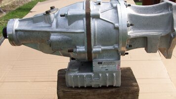

Just heard from the shop.. They are thinking the front differential needs rebuilt, or replaced, to get rid of vibration.
f|_|c|{! Got a feeling XUV is going 2wd for the remainder of this year.
hmmmmmmmmm....
There is a Envoy XL 4.2 in my local yard with a G80/GT5... I already have the front GT5 diff....
This has me thinking seriously!
