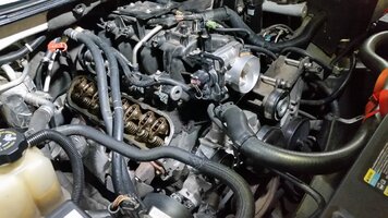

Finished replacing the valve stem seals. Called it quits for the day just as the happy hour gong sounded; will button everything back up tomorrow. Out of curiosity, I compared the old vs. new seals using a go/no-go test with drill bits. The new seals were a firm go at 19/64" (.2968") and no-go at 5/16" (.3125"); the old seals were a loose go at 5/16" (.3125") for a difference of at least 1/64" (.0156"). The new seals have a lip at the inner edge of the seal face that wipes against the valve stem; that lip was gone on all of the old seals. Time will tell if this is the root cause of the oil consumption.

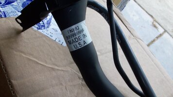

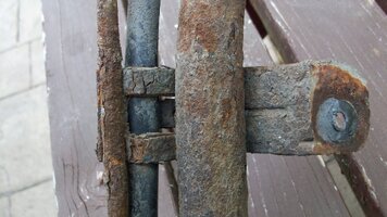

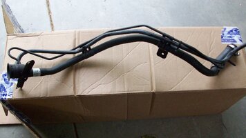

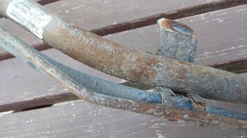

Replaced the fuel filler assembly on the Nox. (Hard to believe that a 2015 could get this rusty) trying to chase down the cause of the PO442 code. Couldn't find any leaks pressure testing but, it probably would have leaked soon. Couldn't believe "made in USA"... :2thumbsup:
DA81FC57-CFC6-43C6-B986-0A460456EA3C.jpeg993E6C44-05D3-4B06-9CDE-BC97CF418F1B.jpegACC442A9-1FB0-41C8-8A28-0BFE0546B501.jpeg680792B1-BA84-40B2-921D-919B81F66854.jpeg

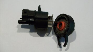

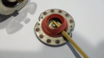

In chasing down the PO446 or better said throwing parts at it. I believe I found the culprit. Did a forensic on the replaced Purge sol/valve and found a ruptured valve membrane. Even with all the parts still only about $150.00 and some swearing.34D88DD6-5BFB-4EB4-9BE0-F45F50EB0A8F.jpeg562007E9-2AA2-4DE7-9DF3-1291F32CDEDB.jpeg

In chasing down the PO446 or better said throwing parts at it. I believe I found the culprit. Did a forensic on the replaced Purge sol/valve and found a ruptured valve membrane. Even with all the parts still only about $150.00 and some swearing.View attachment 108522View attachment 108523
I replaced that on my wife's '06 TB last year when I had it torn apart to replace the valve cover gaskets. She'd been getting a CEL for emissions, and since the part was right THERE I replaced it.

500 mile checkup on the oil level after replacing the valve stem seals. What a difference! Previously, I was seeing 1 Qt loss in 1000 miles (or less!) so I could expect to see ~ 1/2 Qt low at 500. Not any more; I am now seeing way under 1/4 Qt (more like 1/8 Qt). Looks like oil consumption is now in the range of 1 Qt per 3000 miles. Yeah boy!!
Yeah, we're all good now, took a week for the evap monitor to reset, that seems to be the toughest one to get a reset on. Ready for the annual inspection now... :2thumbsup:

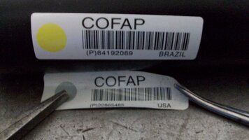

Not mine, but my son's 11 Silvy. He asked that I bring my A/C stuff to the campground to fix his that stopped working. Hooked up the gauges and it just had a hair of pressure in the system. Vacuumed it to 30mm/hg and it held for over 30 minutes. It's probably just very slow seepage and is likely the first time it needed a recharge. Filled it with the proper amount and was blowing cold again. The went over it with the leak detector and couldn't find anything so we're calling it good for another 12 years.
