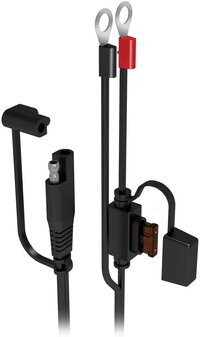

Mike... I know this next thing LOOKS like a "Pretty Pricey Bit of Kit"... but for anyone owning any Expensive AGM Batteries that really wants to keep things working properly at all times...THIS THING is the Best AGM Battery Trickle Charger AND Maintainer around:
BATTERYTENDER1.jpgBATTERYTENDER2.jpgBATTERYTENDER3.jpgBATTERYTENDER4.jpgBATTERYTENDER5.jpg
Ever since I almost lost the use of my AutoZone Platinum AGM Battery and right after resurrecting it with an Optima 1200 Battery Charger-maintainer:
...I've been keeping things going along flawlessly with it by using this "Battery Tender" Unit. Now, whenever I want start the Y2K Silverado after it has to sit unattended sometimes for weeks on end (Thanks to COVID-19 Isolation), it Starts Right Up in less than 5 Seconds and the Battery Power is always at Peak!
After10-15 Minutes of idling, the Top End-Valve Train and all Engine Bearings get nicely refreshed with Mobil1 Motor Oil and I can leave it again for a while and NOT have to worry that it will NOT Start in the future.
