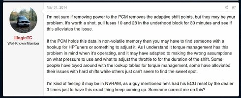

Spent the rest of the day doing some reading. I'm still unsure why the Envoy is giving me a very firm/hard shift from 1st to 2nd, enough to chirp the tires at anything more then 30% throttle. My conclusion is I either put the wrong 1-2 accumulator spring in (purple Sonnax one), or my accumulator housing has slight wear causing it to catch. I ordered up 2 Delco springs, both identical to the orginals to throw in there to see if it helps. It never did it before, until changing the piston out for the Sonnax pinless and the Sonnax purple spring. :confused:

Thank you! I'll try giving that a shot again, I did pull the fuses the first time around when I had the pan dropped to swap them out. So far its just 1-2, 3-4 is as smooth as its ever been.

Pulled the fuses from @MRRSM post, for good measure I pulled the TCM fuse under the rear seat. Left it sitting for an hour, and put them back in and did another test drive. Its not chirping now thankfully, but it still shifts a bit harder then it should but much better! I suspect the extra firmness is from not running the second inner spring, which I think cushions it? I know the thick piston reduces travel also which more then likely plays a part in it. I ordered the OEM springs to throw in to replace the Sonnax spring on Tuesday while doing the shift kit. This should give me the firmer shift, while making it softer at the same time.
Also bright side with the coffee can loped off, I now know my TCC valve is a bit worn. I'm able to hear the slight change in exhaust tone while driving on the highway. Its very faint, but noticeable. So I'm glad I have the kit to get it swapped out before it actually gets worse.

After leaving work, 1-2 is back to chirping again like it was before. I've got the PCM and TCM fuses pulled again, I'm going to let it sit for a few hours to let it reset fully hopefully. It cleared up last time, but I suspect it could be that it needs to be driven to work the trans lube out of the accumulator bore, or the fact the OEM springs need to be worked in. Either way, it should clear up again hopefully. Its not an overly harsh shift like I mentioned days ago, but its still a bit on the stiff side.
