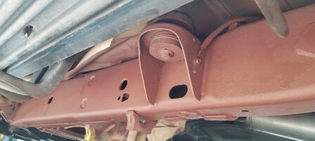

Also cleaned up some surface rust above the spare tire. The receiver hitch and the cross brace in front of the hitch will need more attention later.
I started to wipe the area near the ground strap with acetone but the original undercoating, whats left of it, didn't like that as expected, hence the slight wrinkling.
Also cleaned up the frame rails last weekend, did both the frame rails and above the spare tire with some wire wheel cleaning and sanding pads.
Used the trusty rustoleum rusty metal primer for both areas, then topped with black enamel. Wish I used flat for both but no big deal, satin on the frame has a bit of sheen to it.
