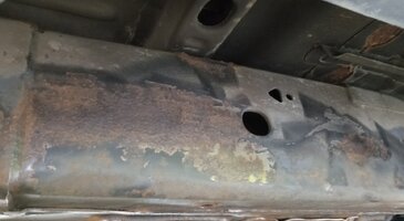

This will probably turn into a seperate thread, but went to knock down some surface rust on the frame, little bit of prevent.
Then I found this area on the inside near the muffler.
I'm quite surprised and frustrated I found this now, could have and should have been addressed sooner but that's water under the bridge.
This is mostly on the top radius extending down the inside of the rail. This is one isolated area, the rest of the frame on both sides has mild surface rust, but this will need attention sooner than later.
My plan is to remove the exhaust, loosen the body bolts, loosen the fuel filler neck and basically lift and pivot the body on the front bolts or front of the body mounts, so I can gain about 4-5" of clearance to clean up that area.
I don't know the limitations of welding on a frame, but the idea is to clean that area inside (if poss) and out, then secure a 1/4" steel reinforcement in that area.
I could likely clean that area up.and stop the rust and just continue on, but if all possible, would like to replace what has been lost.

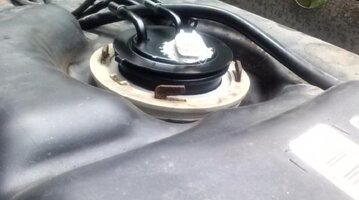

Removed the fuel tank, exhaust from behind the cat, spare tire hoist, so I can knock down some surface rust on the frame.
Going to replace the spare tire hoist also.
The fuel pump was replaced in 2013, upon removing the tank I noticed the top of the pump has rusted quite a bit...:mad:
So would be wise to change it now while it's out.
Bummer is I even painted the new one 7 years ago.

Meant to add, that pic WAS the new fuel pump 7 years ago, I need to drive it Monday night, cheapest local parts store has a new pump at $270....daggone. may slab some grease on the rusty nipples....:eyebrowhuh:
.....and just let it go for awhile. Dunno yet.
