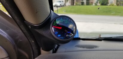

finally had time to mold the trans temp pod. *hint* if using a "universal" pod you might want to get the pod just shy of too hot and actually press it onto the pillar this worked much better then heating, bending, checking , reheat etc.

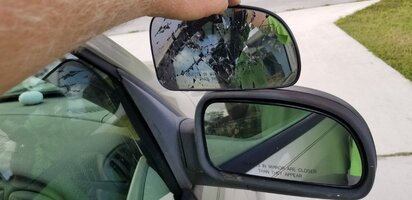

also swapped out a side mirror when i clapped a leaning mailbox. it didnt hurt the side mirror shell but the shock broke the glass.
>=[ this mailbox has since been kicked back upright to save others mirrors...

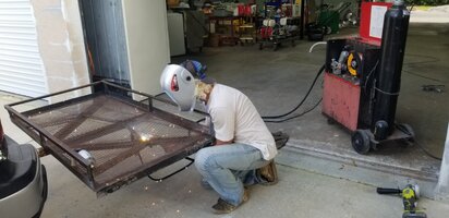

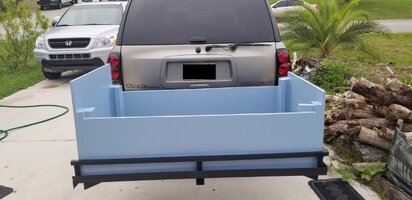

added some angle under the carryall to help the expanded metal distribute weight and prevent bending.
sealed and painted the carryall and box so i wont have to build another for a long time. i'm not a fan of the color and i will repaint when i decide on the color. but this was leftover exterior paint from my house that is very good stuff. (elastimeric)
the box is wide enough to allow full lift gate operation.
