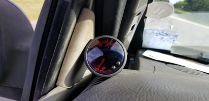

finally got my trans temp installed. (again) Ordered from Glow Shift. when i attempted the 1st time i ran the sensor and power wires had everything soldered in and then attempted to plug in the power harness to the guage. they were different sizes >.> go back to the packaging and realized they sent the wrong harness. 2 hours on the computer (because no one answers the phone because of the 'rona) and another week for shipping. i finally received the correct harness today. my fault for thinking they could send the right one and not checking 1st. now it is set-up and running. and now just awaiting the shipment of the enclosure for my pillar. all in all the gauge looks pretty, the product seems cheap (wires are majorly thin and were only 16'' long) but it works as of now. i dont think i would order from them again because of the customer service.
if the gauge looks hard to read it is because it is. the gauge has a tinted face so the enclosure should help with making it darker and killing the glare. it also makes me want to tint the windows now.

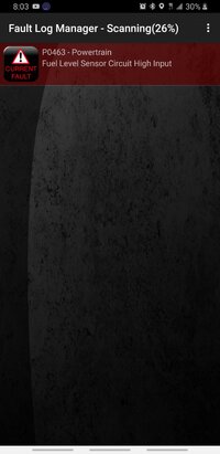

Used my new scan tool and looked up the airbag light code. As expected, front impact sensor (most common cause of airbag light on the GMT900 series trucks when they get old). Right side. Ordered a new one. Dorman -yes I know, but no one has found a difference between the Dorman unit and the OE, except it is half the cost. Some suspect it is the same part just relabeled by whoever sells it. It should be here later this week.

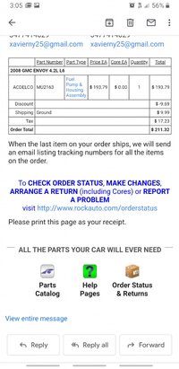

Ordered another fuel pump for it. I could not locate a reasonably priced Bosch for it so I went with the acdelco. Hopefully this time I won't have any issues. Current issues are flacky gas gauge and code p0463.Screenshot_20200229-080350_Torque.jpg
Also it won't start after warmed up and takes another try with the key to get it started sometimes even needing a third try.
