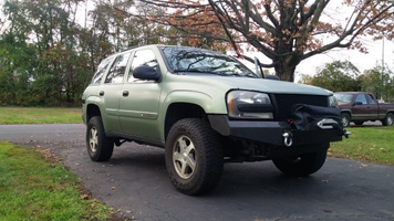

Replaced all the ball joints and tie rods. Also replaced the front brakes upgrading to the bigger SS rotors using the caliper brackets I picked up last year off an 06 EXT. I got the ACDelco Advantage rotors because they had the good coating whereas the Pro just had paint. And they were cheaper. However I did use ACDelco Pro pads. Got the alignment pretty damn close too. It will be interesting to see how much better these brakes will be.
