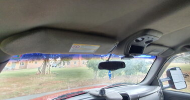

2) SUN VISORS
I didn't like the old-style visors (with no extension to block pesky side-sun) so I picked up a newer set with the plastic piece that extends. They look a lot less 1990s and are more functional now.
Left is new, right is old.

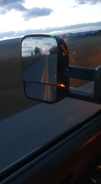

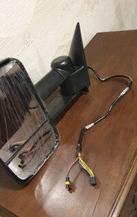

3) TOW MIRRORS
I purchased a set of 2nd gen (03-07) towing mirrors. The new mirrors support more features (like memory) and are supposed to plug into the DDM/PDM with two 10-pin connectors, whereas the old mirrors had less features and plug into a single 8-pin connector. What a dilemma; some splicing was in order.
The new set is power-adjusted, has defrost, and turn signals, so every wire mapped 1-to-1 except for the turn signal which I had to add a new 2-pin connector to support.
I love the look of these mirrors and the visibility is so much greater. I'm really ticking the boxes on my mod list.

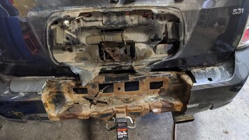

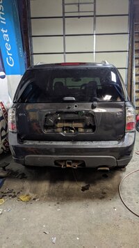

Replaced the rear bumper cover and hatch/tailgate. I had to cut the hatch open to release pressure off the floor/latch, from whatever hit the vehicle.
Also changed the transmission fluid to find that nice little exhaust pipe to be right in the way! That was fun surprise to find. I just left the pan hanging up there on the exhaust pipe and cleaned the pan and gasket sealing surface while it was up there. Swapped out the filter as well.
Next is replacing both the rear wiper and wiper motor.
