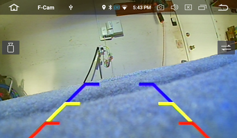

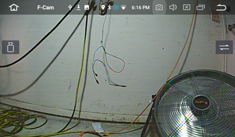

Got the replacement cable for my new backup cam, so got around to installing that. Had never seen this type of connection before, turns out it's called CVBS, and appears to be more common than I thought. The cable they provide is long as hell, something like 26' I think. When you think about it, all of them should be that long, so you don't need to use extensions and additional connectors. I didn't feel like tearing out my interior and dash again, so I just bundled up all the excess in the cargo section by the amp.
Made sure to do a test run before messing with the rubber boot again, not to mention making sure the camera worked. Laid it on the cargo shelf, and was impressed with the picture quality. I think it's rated at something like 600 TV lines, so my expectations were low. Granted, it's being viewed on a 10" screen, so that helps.
Snipped the appropriate loop to get rid of the reversing lines, since the HU has them as an option, and I don't use them anyway. Modded the trailer hitch cover with a cut piece of scrap metal, since the camera is smaller than the original hole I drilled. Painted the metal black, and siliconed it in place. Fed the camera wire through, and routed it to the driver's side tail light. Note, would have been smart to check the length of wire on the camera first. This one was considerably longer than the previous 2. The connector could have been fed through the tail light grommet much easier due to the smaller diameter. Ended up tearing the grommet forcing the larger harness side connectors through. Oh well, taped em up real good, so it's fine.
One more test post-install, may need to adjust the rotation a little bit, but think it's pretty good. Will record a short video on the drive to work, to add to my Amazon review, so I can get that refund back. :biggrin:

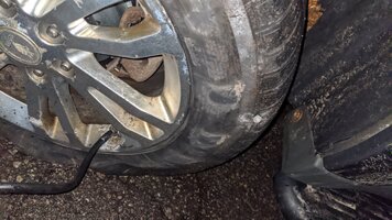

Found out yesterday my front right tire was at 20 psi. Hm of course that's the one my TPMS sensor is dead in. Aired it back to 40. This morning tire is at 35. Ok, so a slow leak somewhere...
*edit* checked just now and it was down close to 32 psi. So, appears I lose roughly 10 psi every 24 hrs. Aired it back up around 42 so I should be good for going to work tomorrow and back. Looks like a tire shop visit for a leak repair is on my to do list this week. Hm, maybe have them put in the "new" (now 1.5 year old never installed) tpms sensor while they are at it and get rid of one dash light. Still have to figure out the airbag light. Anybody in the Columbus area with a tech 2?

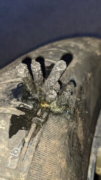

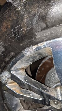

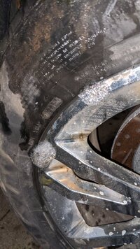

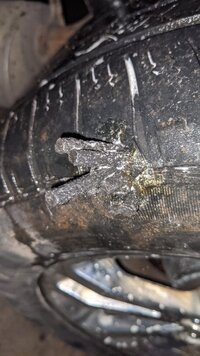

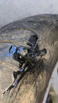

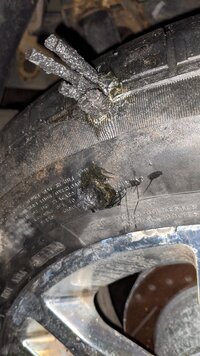

Decided to have a little fun in seeing how well the tire plugs kits can really "repair" a puncture. I have no intentions of EVER using this tire... Just having some fun in testing.
I pulled the tire off and then pulled the screw out of the tire and let most of the air out of the tire. Only to find that the "hole" looked more like someone stabbed it with a knife and then put a screw in place of the knife. :eyebrowhuh:
I tried one plug, knowing I would need more and that started to bubble as I was applying extra glue. So, I immediately added a second plug.
Four-five plugs later... I let the glue dry for about an hour and decided to put some air into the tire.
I hear the hissing sound and grab my water and soap mixture to spray on the tire. I find three leaks... On on the sidewall of the tire and two at the rim. :bonk: So, I plugged the sidewall hole, waited for it to dry, put air in the tire and called it quits. :rotfl:
