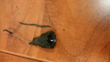

Here is the knock sensor pigtail I replaced. Not as much fun as I anticipated but at least it was done in a warm garage. Used a heat shrink butt connector with another sleeve of heat shrink tube over it all.
Definitely looks like it needed replaced! Sounds like a good repair.

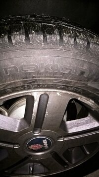

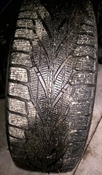

Last week, when my Michelin X-Ice went to 2½/32nd and would not clean out existing snow very well... I found 4 used Nokian Hakkapeliitta R2 SUV 235/65R17 XL snow tires.. $300 not bad since there is only a bit of lingering winter weather right now. Strange name for tires so I had to look up the meaning of: Hakkapeliitta.. not being Finnish and all that....
Hakkapeliitta is a historiographical term used for a Finnish light cavalryman in the service of King Gustavus Adolphus of Sweden during the Thirty Years' War. Hakkapeliitta is a 19th-century Finnish modification of a contemporary name given by foreigners in the Holy Roman Empire and variously spelled as Hackapelit, Hackapelite, Hackapell, Haccapelit, or Haccapelite. These terms were based on a Finnish battle cry hakkaa päälle, commonly translated as "Cut them down!" The hakkapeliitta-style cavalry was first used during the Polish-Swedish Wars of the late 16th century. In the early 17th century the cavalry led by the Field Marshal Jacob De la Gardie participated in campaigns against Poland and Russia. The Hakkapeliitta cavalry men led by Field Marshal Gustaf Horn were vital to the Swedish victories in Germany during the Thirty Years' War. Finnish military march Hakkapeliittain Marssi is named after hakkapeliittas. I'm finding that I actually like these tires..

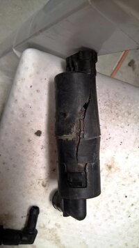

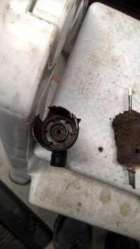

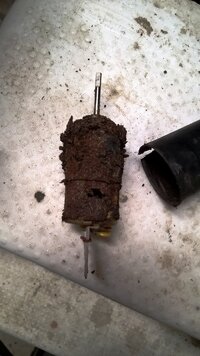

Last night I decided to replace my headlight washer pump.... which I figured was bad because someone let it freeze.. a long time ago.. I'm pretty sure the picture proves that.. but I did break the outlet going to the headlights... getting the aged line on. They still don't work so.. going to check the relay .. which seems to have been installed backwards.. but still don't work.. going to check the two nozzles to see if they also froze..
You do know how those work on these wacky Saabs? For every 4 times you use the windshield washer, it activates the headlight washers. Jump the relay to test the pump and washers.

Relay was in backward.. you have to be in drive, headlights on .. actually every third press of the washer button.. only the passenger side works... the hose to the drivers side runs in a channel next to the radiator... I have to drive into town tomorrow maybe it will warm the hose up enough to let washer fluid get to that one.. or maybe that one is bad.. attaching more pictures of the inside of the pump... looks like someone had water only in it when it froze.
