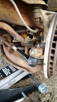

Went to inspect the front brakes on my C1500, which I have been incorrectly calling the K1500. My truck is indeed only 2wd but K code with the 350. My mistake. On that note... I pulled the slide pins out, which were bone dry. They got a wipe down and fresh silicone grease. The iron on iron caliper slide area was quite rusty so I knocked it all free and put in a small amount of silicone grease and worked it in. I will give GM one on the board for how easy it was to rip the pins out.
Issue 1: The bleed valves are rusted in. I hit them again with a wire brush and penetrant. Using a 10mm wrench I had no give on either direction. I will keep working on them... Not surprising since they had no rubber boot on them.

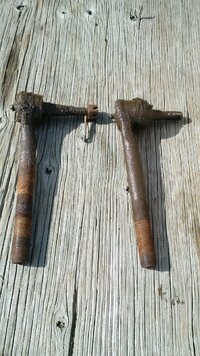

Issue 2: The driver side outer tie rod end had a decent amount of play in all directions. Just great. I filled it with grease again and dosed everything with penetrant. I ordered some cheapo ACDelco Advantage outers from RA, which should be here sometime this calendar year. They are greaseable, 16 bucks apiece all in and will monitor any wear. I put maybe 4,500km on this truck in 1.5 years so it is not a high miler. Those Moog were my top choice but I wanted to test out the cheapo line.
Oh well, they look original, making them 26 years old with 375,000km on them. For 32 bucks, no biggie. The wife wants me to source out a parts truck as well from Chickenman (aka Towman), who is our local tow truck/wrecking yard guy.

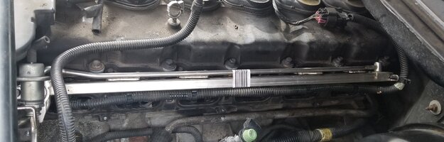

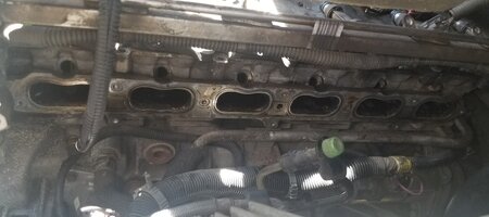

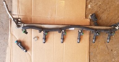

Quick update, new injectors on clean rail...they are stubborn to remove and reinstall to the rail, even with the seal oiled but not terrible.
Leak test passed, had to do this before reinstalling the intake...Murphys law. Pressure regulator has to come back off to get the intake on but I'll take that over the whole intake.
After a road test, I can say for certain it feels better. Not a huge difference, but overall driveability is better, quicker to level off at speed under part throttle, seems quieter also.
I'll give it a few days and let the fuel trims smooth out, among other sensors.

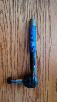

2 hours and I installed the new outer tie rod ends on the C1500. Used ACDelco Advantage line. They used the same rubber boots from what ever TRE's were on there. The new ones used a nylon lock washer and the old ones used a cotter pin.
Was easy enough to do with simple hand tools. Hardest part was unscrewing the TRE from the adjusting sleeve on the driver side. Needed to break it loose with a pipe wrench. Other than that, it was simpler than doing them on the Tb. Also greased up the ball joints and steering linkage.
In hindsight I should have also done the inners as they were loose but no play detected. Oh well, another project for another day.

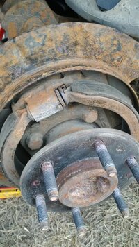

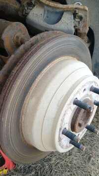

I decided to adjust my e brake today. It has been less than useless since I did the rear brakes 2 years ago. I used Napa premium coated rotors and I think the drum diameter was off, causing next to no shoe engagement.
Took less than 2 hours from setup to cleanup and test drive. The hard part was done when the rear brakes were changed. The caliper bolts were welded in and the rotors had to be destroyed smashing them off with a sledge and air chisel. A little torque and they came right out and the rotors popped off easy.
I adjusted them on the conservative side as they were not quite dragging on the drum. They locked solid in reverse and slid free at 1400rpm in drive. I could also lock them up on the dirt road and skid nicely.

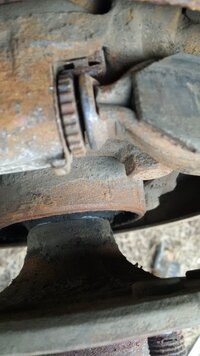

Pics or it didn't happen. I also inspected the passenger side axle seal. When I did the brakes 2 years ago it looked like it was starting to leak. It did attract a bit of dust but I will leave it as is. Seems it is just weeping. Also the condition of the Napa Premium coated rotors. Rust is at decent levels but they are grooved up. The joys of dust and gravel road driving.
