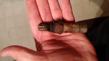

Yesterday I thawed out my GMT400, GMC 1500 rez rocket in the garage bay at work. After I installed the new EGR solenoid, O2 sensor, T-stat and cap/rotor/wires.
Big difference every part made. The old cap/rotor/wires were some unknown aftermarket parts. The aluminum terminals were well worn and corroded. The connections in the plug wires were so-so. Some were full of rust. The cap was loose and the rotor was well worn and showed signs of arcing. The new, cheapo United parts were decent quality silicone wires, all brass terminals. This really cleaned up the engine. Idles smoother and cleanly pulls through the RPM range now. I have a straight pipe, true dual exhaust with no crossover so it was obvious which bank of cylinders were firing right and which were not. It sounds really good now..... I really need mufflers as I feel like a 16 year old white trash kid driving circles around town during school lunch hour.
The O2 sensor (ACDelco Professional) was original as far as I could tell. Without testing it, who knows how well it operated. It came out easy using a wrench and the new one slid right back in. The old one appeared original that would be 26 years and 374,000km.
EGR solenoid (ACDelco Professional) was a simple swap. I had done a hobo test and cleaning of the EGR valve. It "appeared" to hold vacuum and did move somewhat freely. Now I should have bit the bullet and ordered a new one and will do so in the near future. It almost cured the low speed stumble that plagued the truck. It is barely noticeable from a dead stop now. I blocked the vacuum line from it until I get the new valve. So it still throws a code 32. Valve and solenoid look original too.
New T-stat (ACDelco Professional) was a somewhat simple swap. I should have drained more coolant first but was on a time crunch so I just winged it. Minimal loss but just a pain in the ass. Oh well it went in fine and really cleaned up the operating temp. The old one was lazier than a passed out rubbie. Now she warms faster and throws a ton of heat in the cab. Old one appeared original.
Just waiting on the Delphi knock sensor and then will install the new pigtail. Hopefully this will cure the code 43.
