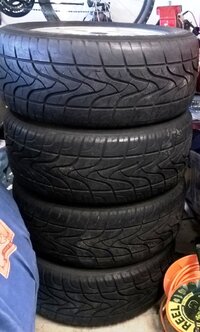

I drove over to the Seattle area (236 miles) to pick up 4 more Saab wheels with tires that will eventually be winter wheels.... I could pass up the price of $100 for all 4. Left at 5 in the morning.. took my neighbor along as he was going stir crazy in this 1 dog town.... Stopped at Popeye's Chicken.. .. which has a lot smaller pieces since they got purchased sometime last year... sort of poor quality tires.. can't even find out who makes them.. Clear HS277... didn't buy them for the tires anyway... With stops.. it was about 4 hours each way.. Nokian tires.. were nice and smooth and handle the mountain roads just fine...

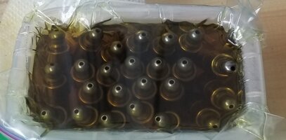

- New lower o-rings for the injectors (after cleaning them)

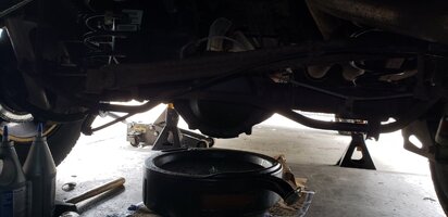

Finished doing the differentials on the Avalanche, all I need to do left underneath is swap out the tranny pan + do the solenoids (nothing like preventative maintenance right?). Also received the new bearing for the lower steering column/shaft that has the "rattle/clunk" when going over bumps. Going to attempt doing it tomorrow if it doesn't rain. Also scheduled an appointment with the shop that did my Envoy's alignment, gonna have the front end looked at on the Avalanche and see what else it needs so I know what to tackle this summer/hold off until next year.

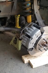

Tried attempt #1 at replacing the lower steering column bearing. Failed to get it changed out, tried loosening the lower intermediate shaft to no avail. I get it to the point where its about to slip off but won't go any further, going to attempt again tomorrow or another day when it isn't raining. Trying to do this without removing the adjustable gas and brake pedal along with the bracket assembly. Of course the YouTube videos look like they can pull down the shaft with ease, but here I am fighting tooth and nail to get it almost free :Banghead:
