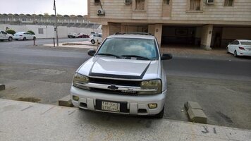

Was out for a drive today.

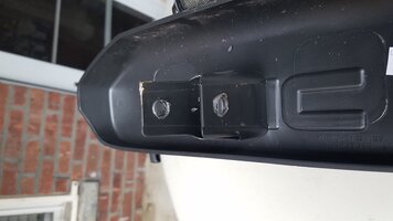

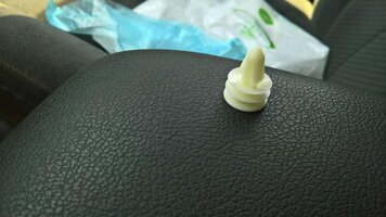

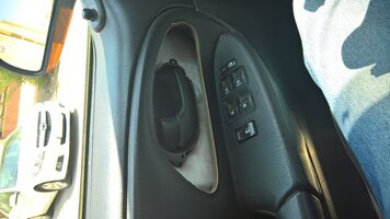

Have to fix the broken door handle trim piece. It fell off when my father was driving the car. Have a replacement, just need to put it. Also a few of the door panel clips broke waayy before when I installed the side view mirrors, so might as well fix the whole panel up so I bought some clips as well.
Also got a cigarette lighter extension so I can hide the car inverter under the passenger seat as well
