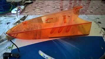

Been quite busy with my Trailblazer the past week or so. Got the Led Side view Mirror Turn Signals in. Painted all my brake calipers red. Also filed the end of my new exhaust pipe and painted it black

Was yours already wired for the turn signal?
Yep I had the mirrors changed earlier so I just added the LED strips cause the bulbs rarely showed up in the day time

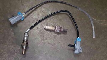

Last night...I replaced the Upstream 02 Sensor since it looked original/factory and looking to get the best MPG possible...

Ordered AC Delco for both parts but the Actuator has the words "TMI" printed on it. The part number printed on it matches the AC Delco part number...so not sure what that's about.
IIRC, AC Delco has some of their stuff manufactured by other companies. Not 100% if these said parts have the AC Delco name stamped on or not besides the packaging.
