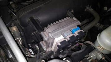

Reinstalled the newly Tuned PCM...
And took her for a drive.
I could immediately tell a difference in the Throttle response and the Shifting of the Trans :yes:. I went with Shift Firmness 1 over option 2 cause I wasn't sure how much of a difference it would make and didn't want it too Firm.
I will evaluate it more since I only went on a 25-30 min drive and drove normal as i didn't want to get to crazy with it since it was in the middle of the relearn/calibration process of unplugging the Battery. Also curious of the MPG after the Tune.
