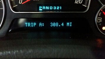

Filled the gas tank up, 17.2 gal, was surprised that my mileage was up more than I'm used to seeing .
That was about 75% hwy/ 25% city, AC on, I did make a commitment that I would try to take it easy on this tank...well, I did for the most part minus a couple hard starts but nothing serious.
I want to see how these new Michelin Defender LTX's do so after about 5K miles they should be well beyond being settled in. I'll try to take it easy this tank as well.
