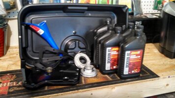

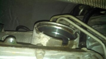

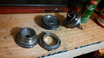

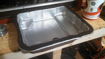

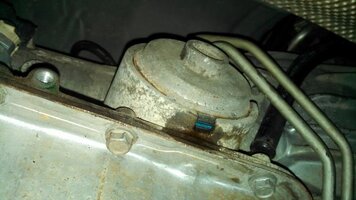

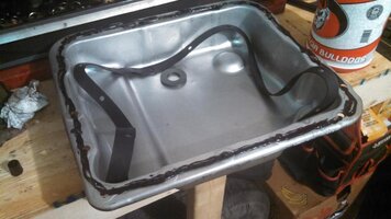

Well I just did a couple of little things today, turned out to take about 5 hours by myself just taking it easy. Installed a Corvette servo and did a fluid/filter change to Dex 6. :thumbsup:
The reason it took so long for those who don't know you have to remove the exhaust mid pipe, rear transmission mount, and lower the transmission down about 4 inches to get to the servo. I had a good time as i find working on my truck quite relaxing, and also figured out a way to get my exhaust about an inch further away from the tranny. :woot:
PICS: it did happen :pictures: Enjoy :celebrate:
