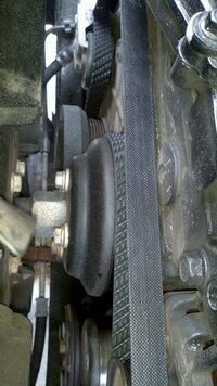

View attachment 25823 Put the new 70.5" Goodyear Gatorback belt in so now it bypasses the A/C Compressor and the idler pulley the voy loves it:yes:

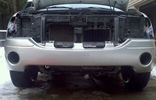

I cut 5 inches off bumper and followed the angle in the corners to make room for the 30" intercooler + piping

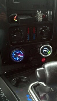

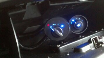

Moved the 4x4 switch and rear wiper (don't use) to the glove box and moved some gauges to the center console.
The glovebox can fully close and open normally.
View attachment 25868 I just need to use black paint to paint around the gauges where I glued their holders

That is going to look good. Make sure there are pictures when you are done

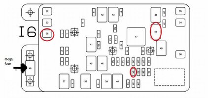

Nice. I plan to do this this spring. I have the block plate already. Aside from the obvious hoses and the pump, what relays and fuses are related to the AIR system that you pulled out? Also, I'm assuming you don't have the factory intake anyways, so maybe your AIR system already was disconnected from the air box? I need to eventually find a stock air box that doesn't have the hold in the side for the AIR system.

Hi thanks. Yes, I have a aftermarket CAI for the time being but I am converting the whole system over to MAF and an 06 PCM so I can run the turbo this spring.
The fuses/relays related to the system are (front fuse box) 54 / 56 + relay 55
