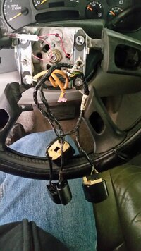

Removed & disassembled the steering wheel in order to determine the where the smoke was coming from yesterday. I will freely admit to no small amount of trepidation since the first step involves removing the airbag.

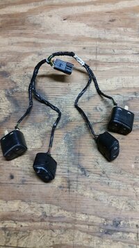

With the steering wheel off I separated the wiring harness and switches from the steering wheel body.
From there, I reattached the steering wheel but with the harness & switches hanging out. The plan was to start up & drive around while watching for any smoke.
My main concern was that it would be coming from (or, worse, behind) the clock-spring. Fortunately, and almost immediately, the Seek/Volume switch got warm and began to smell like burnt plastic.

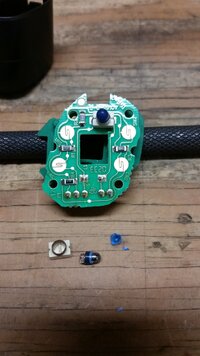

Took the switch apart and voila! One of the illumination lamps was burned out. Inspection of the mini-PCB revealed no damage so I removed the lamp, trimmed the leads, & re-assembled the switch. As Eric O. would say, here's the money shot!
Tested the switch in the harness with power and no more heating or burning. Reassembly & re-installation of the steering wheel was straightforward. No small amount of relief after reconnecting & reattaching the airbag.
