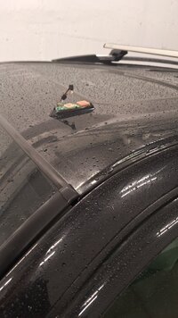

Got in the Voy this morning and before I closed the door I noticed something was off.20250317_064819.jpg
Literally off. Not sure how this happened, my guess would be I took out a bird or seagull. It could have been 1 of my yard cats as I often catch them chewing on 1 of my neighbors' shark fin antenna.20240919_062340.jpg
So your OnStar or XM won't work anymore :laugh: . Instead of replacing it, you could just take it out and plug the hole. Would eliminate that cat problem and clean up the roof.

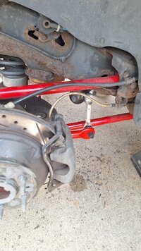

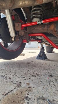

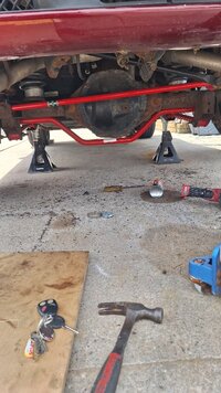

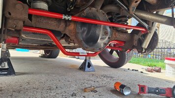

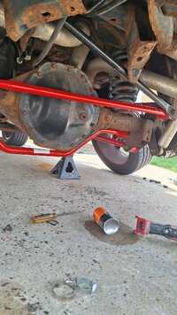

The SS got some much needed attention. All spohn rear upper & lower control arms. Panhard bar. Nolathane rear sway bar, rear endlinks.
Here's some red for all the guys on here who hate my flourecent pink powder coated parts.😁20250419_130508.jpg20250419_130518.jpg20250419_130526.jpg20250419_130646.jpg

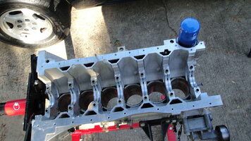

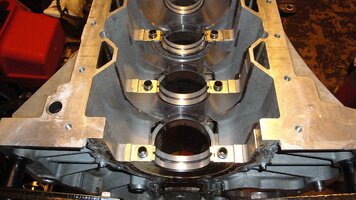

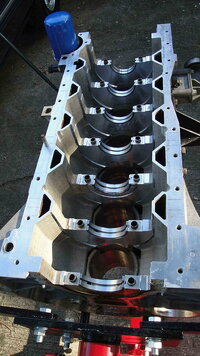

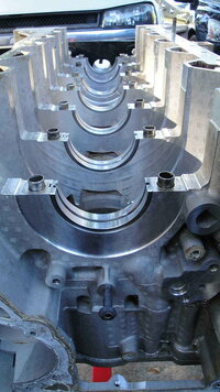

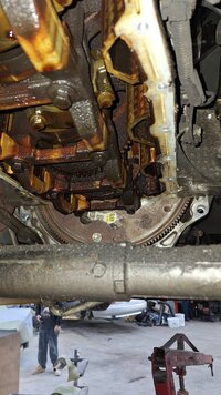

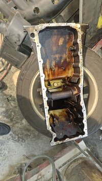

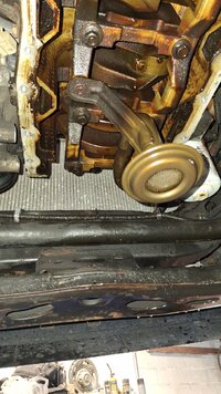

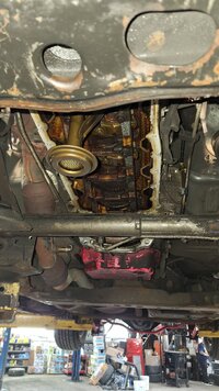

Dropped the Voy of to my trusted mechanic after trying everything I could possibly do to fix a P0017. Unfortunately after 272000 miles it's time for a timing chain, guides, vvt sprocket and all the different seals that need to be replaced.767051522.jpg

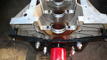

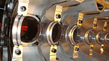

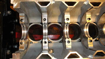

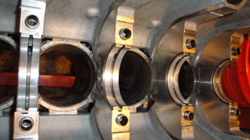

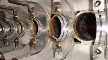

Depending upon the Expense Differences... If you can encourage him to Pull the Oil Pan and get the Front Timing Cover OFF... He will also be able to Pull the Gerotor Pump "O"Ring and Clean out any "Gas Blow By Carbon Gas-Gum and Black Mung" from the Pick-Up Screen as well as completely replace the Timing Chain, Tensioner and Chain Guides with Absolute FREE Access to all of those areas... and REALLY give that motor a New Lease On Life:
49571672127_094c7fa751_c.jpg49571671887_214cc94143_c.jpg49576287002_21d17a86fe_c.jpg49576261842_b976d3651e_c.jpg49576033216_8af0f12bc6_c.jpg49576033246_836538d1e3_c.jpg49576033261_49388ceb6d_c.jpg49575526253_01c098d97b_c.jpg49576033356_6240d6a61c_c.jpg49575526308_0b08c824a5_c.jpg49576033376_376f237fec_c.jpg49576262087_c470fde142_c.jpg50109253108_898232f3c6_c.jpg50109823981_3f8445dcb5_c.jpg50109253133_c1269884db_c.jpg50109253168_20825e487c_c.jpg
More to Follow...

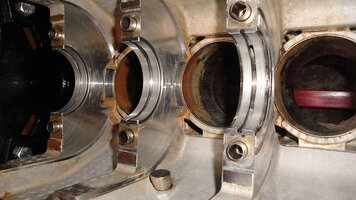

Last Group of Images... Note the Distinctions between the Old Style Front Timing Cover with the Beveled, Shallow Blue Viton "O" Ring Inserted and the NEW Style GM Front Timing Cover with the Updated Orange Silicone Impregnated Vacuum Seal.
These Two Covers cannot have their Gerotor Oil Pumps Inter-Exchanged... This Updated Exchange includes the need to purchase the Melling Update Style Oil Pick-Up Tube and Screen as shown in these images (above and below)
50109253138_56e5266194_c.jpg49576291552_6023ea9bf7_c.jpg49576062871_d6eb44f377_c.jpg49576291607_9d850c51af_c.jpg49576063001_a9db397f35_w.jpg49576291647_d591778c33_c.jpg49575555913_e474ec601e_c.jpg49576291697_b5837ac7fb_c.jpg49576291702_6f539cfe43_c.jpg49575555988_4398ec2c8c_c.jpg49575555993_630d2b0ae3_c.jpg49576058076_a537f60d70_c.jpg49576291827_0c3691c2f3_c.jpg49576286922_f8199703df_c.jpg49576286977_b8614ccdab_c.jpg
...and finally...The Link to my "Flickr-Bucket" for the information of New Parts and Components...Hope This Helps:

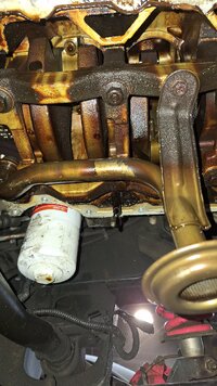

Just some follow up pic's for you guys.
You would think I dont change my oil enough but I do, every 3k to 5k since we've owned it(14yrs) 5w30 mobile 1 synthetic. From the very bottom of the pan and a little more then 1/2 way up the Pick up tube was fine everything else is just gonked up. Gonna cost some extra $$$ but he's gonna clean it up as best he could and throw a new starter in it since its the factory original.20250425_073239.jpg20250425_073103.jpg20250425_073056.jpg20250425_075144.jpg20250425_075138.jpg
Hopefully I'll have it back by Monday or Tuesday the latest.

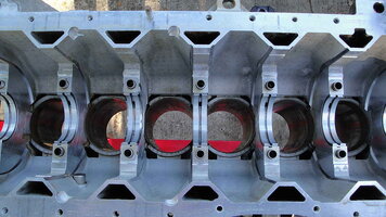

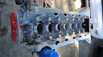

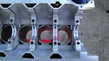

Great News! Incidentally, The "Black Mung" decorating the lower entrails of your Motor (Which Looks Superb in the Top End Valve Train due to Proper Oil Changes over all these years) is due to Excessive Combustion Blow-By Gasses escaping from the Cylinders around the Stuck, Gummed Up Carbon Trapped "Low Tension Compression Rings".
From there, those partially burned fumes enter the Boxy Bottom End, pressurizing that area and driving Engine Oil out and up through those "Parallelogram" shaped Mains Webbing Support Slots in the interior sides of the Engine Block into the areas under the Valve cover, then gets vacuumed through the Small Rubber Elbow into the Air Plenum, then through the Throttle Body and down into the Intake Runners of the Intake Manifold to be ingested during the Intake Strokes... NOT from any Poor Maintenance on your part.
The only treatments that can help this issue over a decade of regular driving are Regular Treatments of using ACDelco Top Engine Cleaner to Break up the Carbon to Metal Bonds on the Piston Tops and loosen the Carbon and Gas-Gum Grip holding the Dual Top Compression Rings inside the Lands and Grooves of the Pistons and around the Valve Seats for a Few Hours of Soaking to dissolve away all of the Carbon Mess. Nothing else will do the trick, save of Re-Rings or a complete engine over-haul... or Pistons & Cylinders being replaced.
Soaking the Crank Case with Berryman's Chem-Dip while it is still off of the Lower Engine Block... WILL completely Dissolve all of that Crap, too... Be sure to clean the slots and grooves of all the Old Gray Hardened Silicone before applying the New Stuff (Permatex High Temp Gray) will ensure that the seal becomes sound again.
Just so you don't feel alone with this common issue...Here is One "BEFORE" and quite a few "AFTER" Cleaning Shots to encourage you:

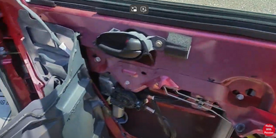

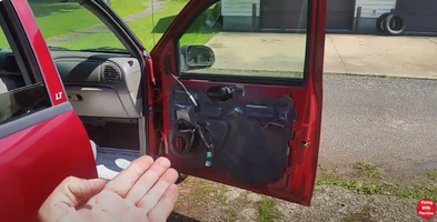

I have a question regarding doors, please help me if you want. I learned that each door has a black rubber cover that shield the cavity once interior door panel is removed. I could lift the rubber shield to do rust repair down to the door seam, but do I need to apply new glue or sealant to put the rubber shield back on & keep it there?
Is that for rear doors or tailgate? :biggrin:
Do you have a photo of what you are referencing?
Yes. I was watching a video of door panel removal.
I can see this cover can be removed easily, but there is some kind of gasket(?) for adhersion on the edge of the cover? Just wondering what that is and can I reuse it after I done my work. Thanks!
I believe you can reuse that tape once you peel back the black backing. It is called butyl tape and can be purchased if you need a replacement.
Much obliged Krunal!
Just dont let that butyl tape get dirty, and you can reuse it.
