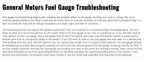

With the problems I had with my stepper motors that's were I would lean the problem towards. Yet seeing the rust on the driveshaft, corrosion on any electrical connections are also suspect. Start with MRRSM troubleshooting guide above.

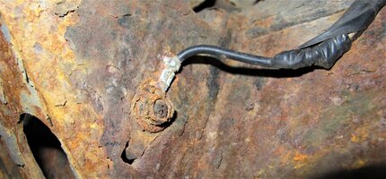

I finally got around to setting the TB up onto a couple jack stand. I found this one ground on the frame just behind the front wheel (on the back side of the body mount bracket.) I wonder if this ground is part of the fuel pump circuit.
It looks terrible.
  • Wow
It looks terrible.
That looks like the ground for the EBCM. Known to cause trouble. TSB for some years directs the repair to remove and discard the terminal and install a new terminal and hardware presumably more corrosion resistant.

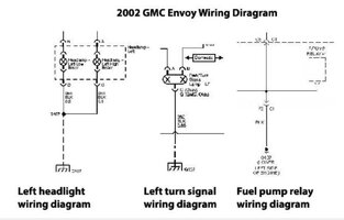

...and for the One that shares the Ground Connections between the Driver's Side Headlight, the Left Turn Signal AND the Fuel Pump Relay... G-107:

Aft of that bracket, there's an identical type ground attached to a body mount bracket (about right between the two doors.) It's close to the gas tank; what circuit is that ground used for?
Wait a second,,,AND the fuel pump relay????
Yup... It goes something like this:
(1) "It's Bizarre... The Engine shuts off whenever I use my Left Turn Signal."
(2) "Whenever I turn on my Headlights, they flutter for a moment ...and then the Motor Dies."
The Stalling happens because these two Different Circuits try drawing so much power and amperage to overcome the electrical resistance from the poor grounding at the G-107 position on the Engine Block that the Fuel Pump Relay is also sharing at the very same time, causing it to drop out. Thus, the Fuel Pump shuts off.

I'm not talking B pillars. This ground is on the frame. More specifically, it's on the outboard side of the frame. On the driver's side; the back of the cab mount bracket. Just below the front door hinges.ground3.jpg
I hit around this area with a slag hammer (will use an air chisel next) to deal with the rust. The bolt for the ground wire spun right out. With the ground disconnected, I tried to start the engine, and it fired right up. So this isn't the ground for the pump or the relay (almost sure now.)
That's the ground for the EBCM. If you get a Service ABS System warning and a code for loss of communication with the brake module, this is usually the cause of it. Clean up the area with a whiz wheel, install a new bolt and nut and coat the shiny areas with rubber undercoating.

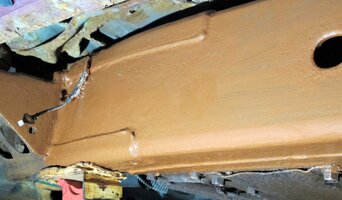

Had a coupon for this cart, so picked it up yesterday. Some assembly required.
Here's the frame after some air chisel work and some light sanding.
