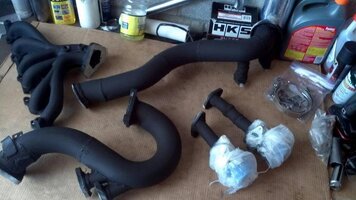

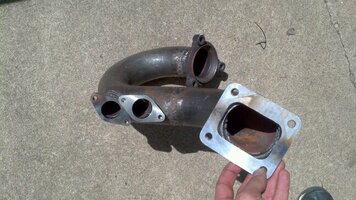

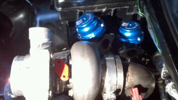

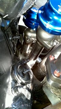

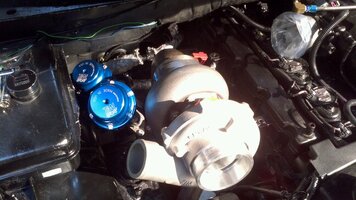

Wastegates are done.

Looks good! Are you going with an intercooler, cant remember now. Or just going to spray meth?
Why 2 wastegates may I ask? It's not a twin turbo setup...
Hey thanks Scarab. and its intercooled (30" x 7.5" x 3")
and sure thing....the reason I am running 2 wastegates is because the size of the turbo is pretty large (almost 3 eco boost turbos in size haha) so I need to by pass a lot of exhaust gas pre-turbo to control low boost (3 psi min - 8 psi max). I went with TiAL just to put my mind at ease...reliability and accuracy with controlling boost is a must...I have just seen to many boost-creep incidents or complete failures at autocross to buy a cheapo wastegate haha

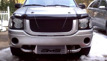

:love0001: the picture of the front end! It is almost as amazing as what is under the hood :jawdrop2:

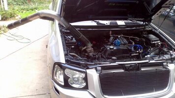

thanks man! say some prayers because today im going to try and turn it over for the first time since march 15th. no turbo yet just a test pipe View attachment 27986
then if it runs itll be boosted and running by next week
ConeKilrAutoX said:
thanks man! say some prayers because today im going to try and turn it over for the first time since march 15th. no turbo yet just a test pipe View attachment 14341
DO IT! DO IT! DO IT! DO IT! DO IT! :wootwoot:
I think a video will be in order for that fire up. I wanna hear how nasty it sounds with that big test pipe. Good job on all your work btw.
I agree, should be interesting noise coming from her with that test pipe. I gotta hear/ see this.:yes:
Thought it was intercooled. :D
I understand that, Im just used to seeing huge turbos on LSx engines with only 1 big wastegate is why I asked. In the 76mm range and getting ~6-700hp out of a 5.3 on an engine dyno. If only I could get that in my TB.:wootwoot:

well it fired up but still is not running right. I am not sure what to do at this point... any ideas based upon what is heard in the video?
I am probably having the computer tuned by limequat again to straighten this out :yes: but in the mean time I will be double checking everything I have done.
it does sound NASTY tho open piped :biggrin:
[video=youtube;9bmfZ91qYj8]http://www.youtube.com/watch?v=9bmfZ91qYj8&feature=youtu.be[/video]
WOW! Thats crazy loud. Are u running ur exhaust all the way out or doing side exit? Right behind the front wheel would be sweet.
I wish i knew more about engines and misfires, im more of a visual diy'er
Only thing i can think of is coil packs or the tune isnt right
And maybe the injectors not spraying propperly
I'll watch the vid in a bit lol eating mcDs and its really loud in here
whats it smell like, does it smell rich?
being that you swapped your harness i'd get a node light, check the wiring to each coil pack, and then check each injector connector.
then check the individual injectors with a battery
Wow sounds greattt! Maybe it just thinks its a muscle car and thats just how she purrs lool
im going to run it all the way out the back but its catless and all 3.25" or 3" piping so she will still rumble haha I want the turbo whistle of spool up and the blow off sounds primarily up front by themselves
good call I have gone through the entire inside wiring and will do as you suggested tmrw. Do you think new plugs would help? only a year old but possibly flooded?
smells like 93octane strongly and im getting greasy gas residue on the throttle body (like dripping) so thats why I want to get 60s instead of 80s
hahahaha yeah its super badass loud but unfortunately not running 100 percent YET :) soon very soon
ConeKiller, I sent you an email!
I think the roughness could be it trying to stall and stall saver kicking in. I may have to bump your base idle a couple hundred RPM.
Otherwise it sounds pretty good I think! Compare to this video, when I first put the 4.2 into the supra.
We'll take some idle fuel out too, but first need to get a scanner on there somehow. You're closer than you think!
